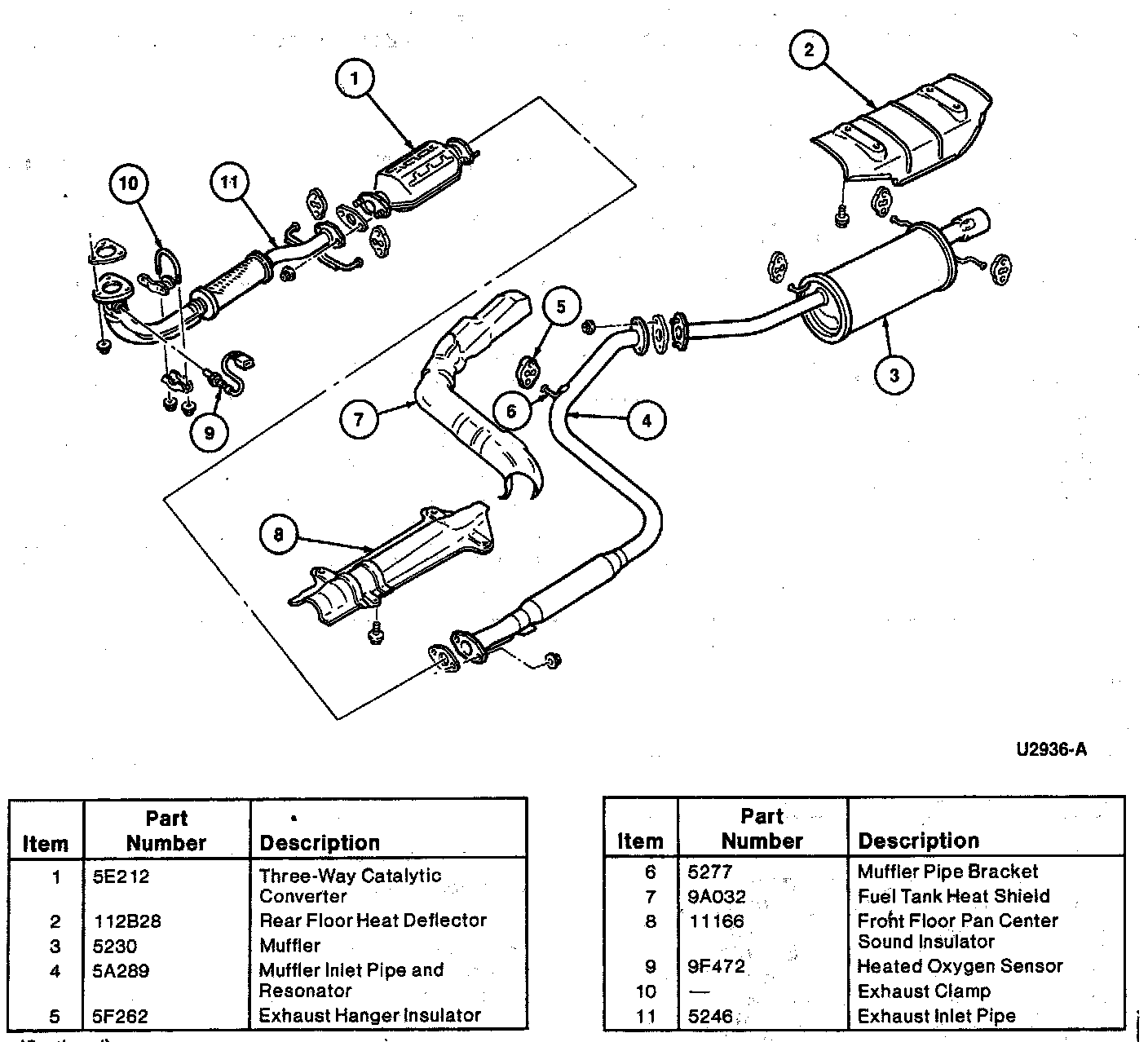

Catalyst & Exhaust System:
REMOVAL
1. Remove two converter inlet pipe to converter nuts. Discard nuts
2. Remove and discard gasket.
3. Remove two converter to middle pipe nuts. Discard nuts
4. Remove and discard gasket.
5. Remove converter.
INSTALLATION
1. Inspect converter for deterioration and restriction. Replace if needed.
2. Place converter in position. Install new gasket between converter and middle pipe.
3. Install new nuts and tighten to 47 - 66 ft lb (64 - 89 Nm).
4. Place new gasket between converter and inlet pipe.
5. Install new nuts and tighten to 47 - 66 ft lb (64 - 89 Nm).
6. Start engine and check for leaks.
