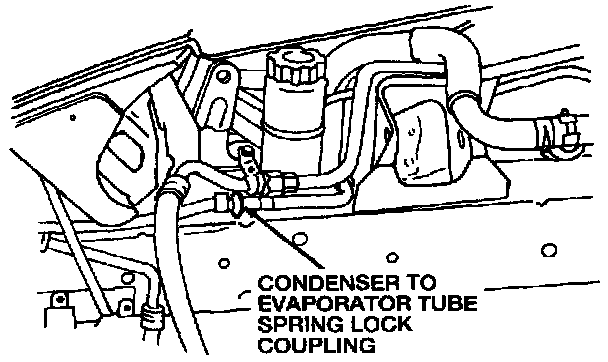

2. Use an appropriate spring lock coupling disconnect tool to disconnect the condenser to evaporator spring lock coupling from the A/C evaporator core outlet hardline (near the bulkhead).
3. Loosen the power steering pump adjuster bolt and power steering pump support. Move the power steering pump to gain access to the spring lock coupling.
4. Use an appropriate spring lock coupling disconnect tool to disconnect the condenser to evaporator tube spring lock coupling from the liquid line extension.
5. Remove the condenser to evaporator tube hold down bracket bolt.
6. Remove the condenser to evaporator tube.
