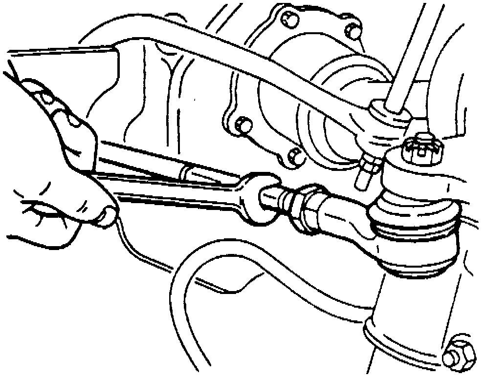

FRONT TOE-IN
1. Loosen jam nuts at tie rod ends, then release clips at small ends of steering gear boots. Ensure boots are free on tie rod ends so that they will not be twisted when tie rods are turned.
Front Toe-In Adjustment:
2. Turn tie rods into or out of tie rod ends an equal amount on each side. To increase toe-in, turn right tie rod toward front of vehicle, and turn left tie rod toward rear of vehicle. To decrease toe-in, turn tie rods in opposite direction. One turn of each side tie rod changes toe-in by approximately 0.28 inch.
3. Check front tracking. Always set tracking immediately after setting toe. Set tracking by using rear wheels as a reference point. Follow equipment manufacturer's instructions to check tracking. Angle of each front wheel in relationship to rear wheels must be same.
4. Ensure toe-in is still within specifications, then torque jam nuts to 51-72 ft lb. Ensure steering gear boot ends are correctly positioned on appropriate sections of tie rods, then install boot clips.
