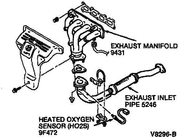

Heated Oxygen Sensor Location:

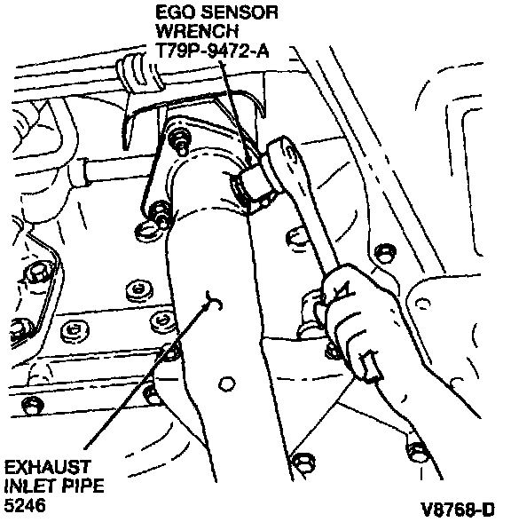

REMOVAL
2. Raise and support the vehicle.
3. Disconnect the Heated Oxygen Sensor (HO2S) electrical connector.
4. Use EGO Sensor Wrench T79P-9472-A to remove the HO2S from the exhaust inlet pipe (5246).
Heated Oxygen Sensor Removal:
