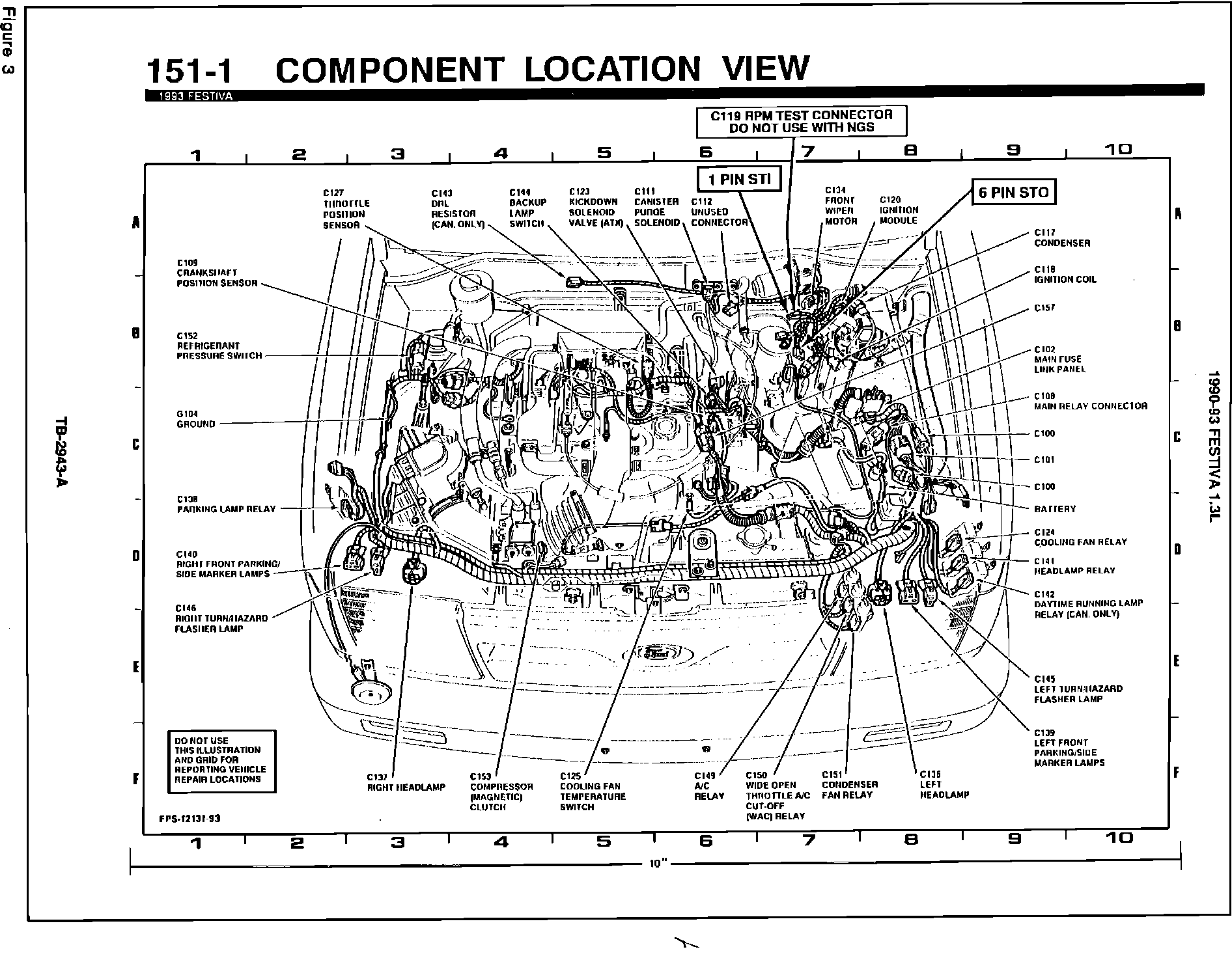

^ For connector locations, refer to Figure 2.
1990 - 1993 Festiva 1.3L:
^ For connector locations, refer to Figure 3.
1988 - 1989 Festiva 1.3L:
^ For connector locations, refer to Figure 4.

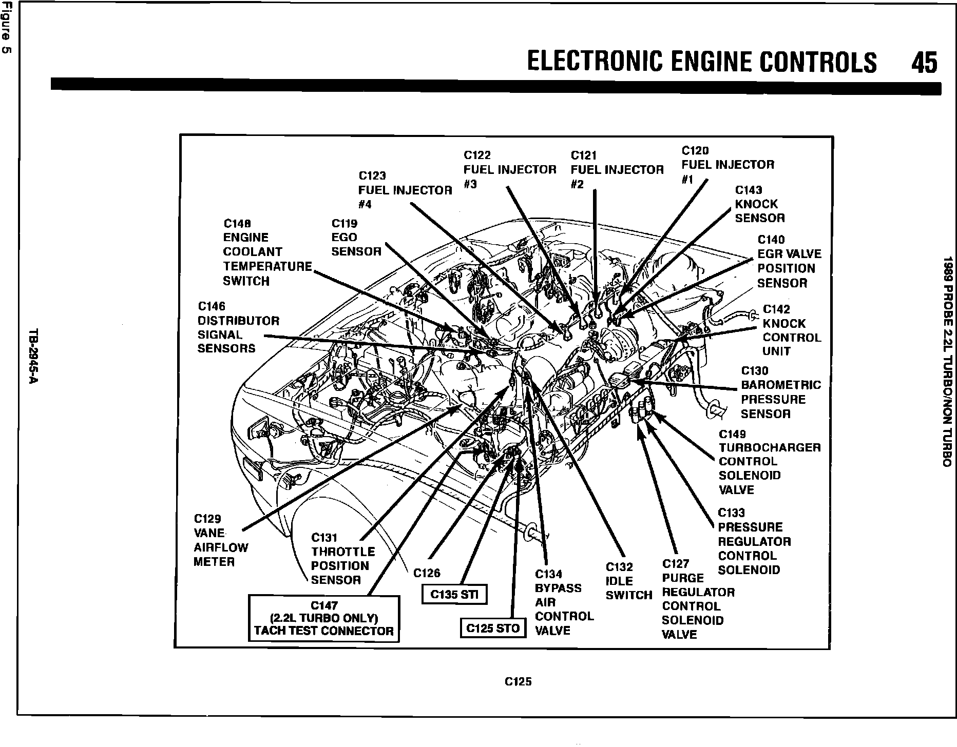

1989 Probe 2.2L Turbo/Non Turbo.
^ For connector location, refer to Figure 5.
