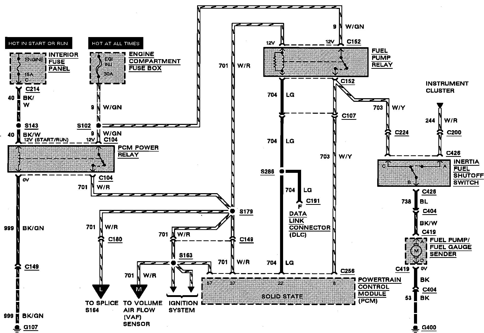

Electronic Engine Control:
DATA LINK CONNECTOR
FUEL PUMP RELAY
FUEL PUMP/FUEL GAUGE SENDER
INERTIA FUEL SHUTOFF SWITCH
PCM POWER RELAY
POWERTRAIN CONTROL MODULE (PCM)

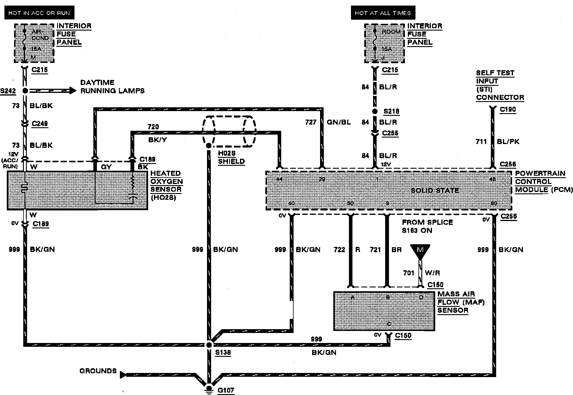

HEATED OXYGEN SENSOR
MASS AIR FLOW SENSOR (MAF)
SELF TEST INPUT CONNECTOR (STI)

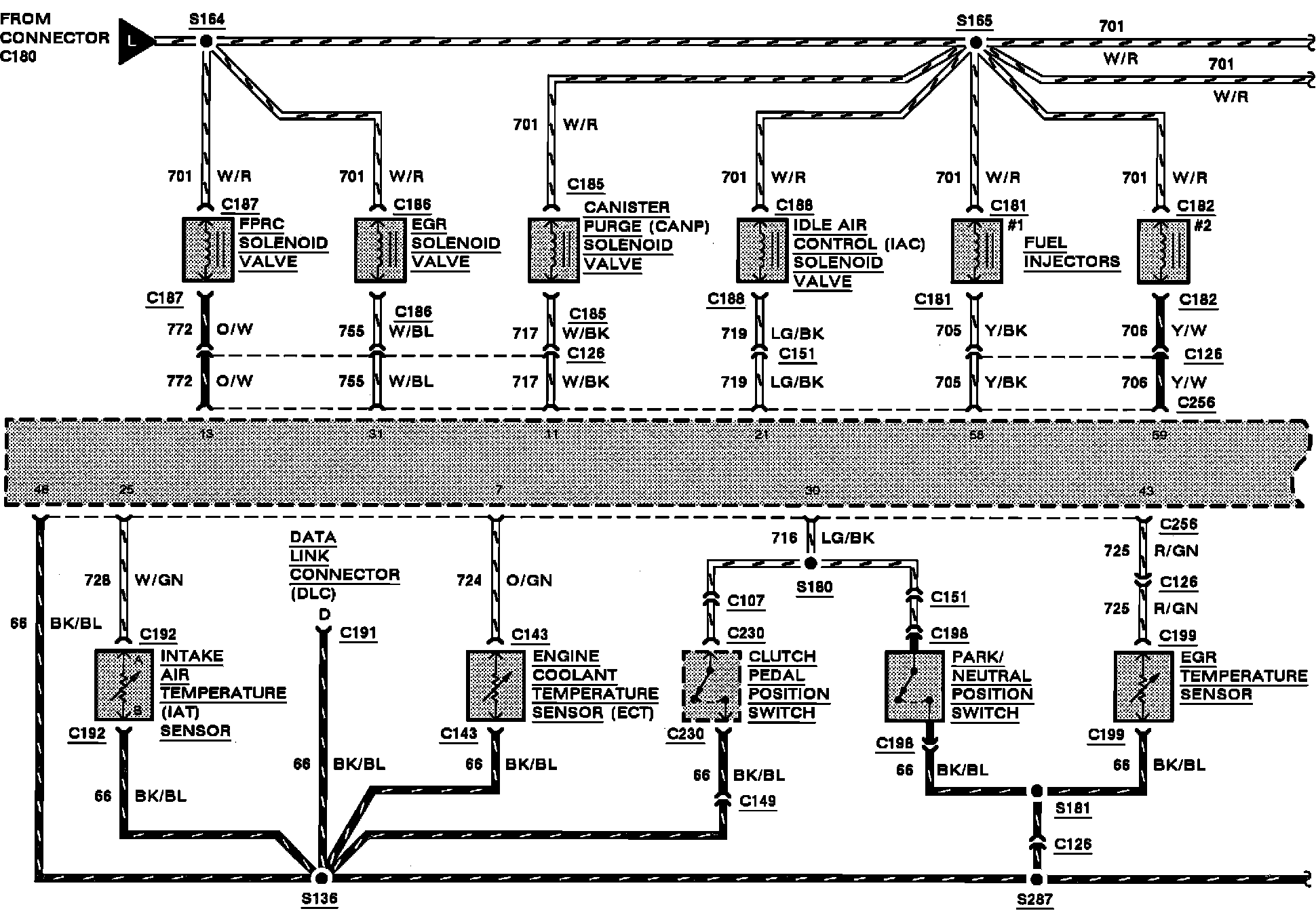

CANISTER PURGE SOLENOID VALVE
CLUTCH PEDAL POSITION SWITCH
DATA LINK CONNECTOR
EGR SOLENOID VALVE
EGR TEMPERATURE SENSOR
ENGINE COOLANT TEMPERATURE SENSOR
FPRC SOLENOID VALVE
FUEL INJECTORS
IDLE AIR CONTROL VALVE (IAC)
INTAKE AIR TEMPERATURE SENSOR (IAT)
PARK/NEUTRAL POSITION SWITCH

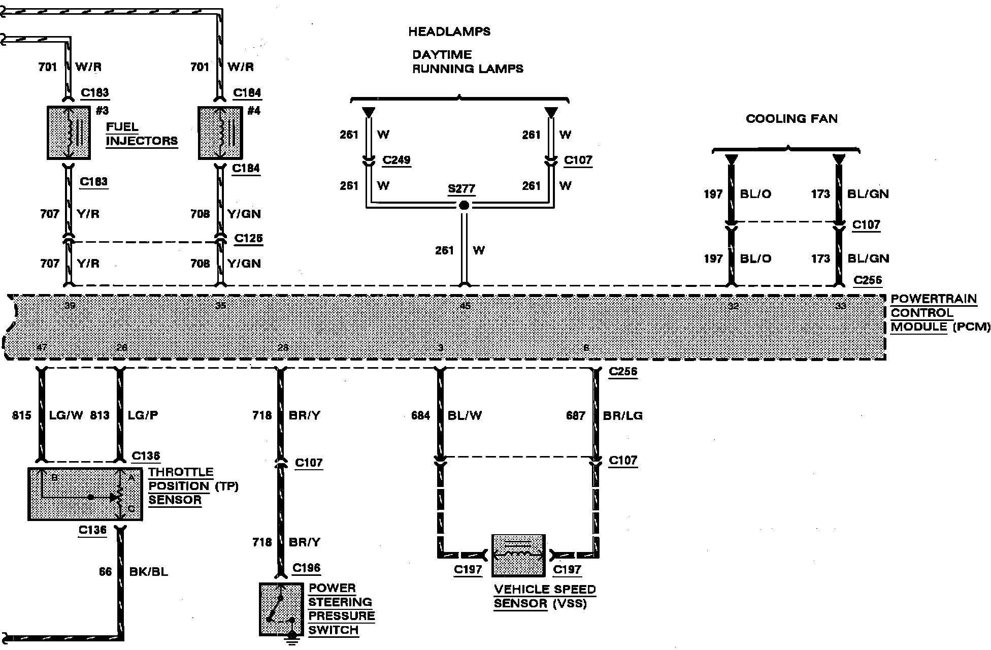

FUEL INJECTORS
POWER STEERING PRESSURE SWITCH
THROTTLE POSITION SENSOR (TPS)
VEHICLE SPEED SENSOR (VSS)

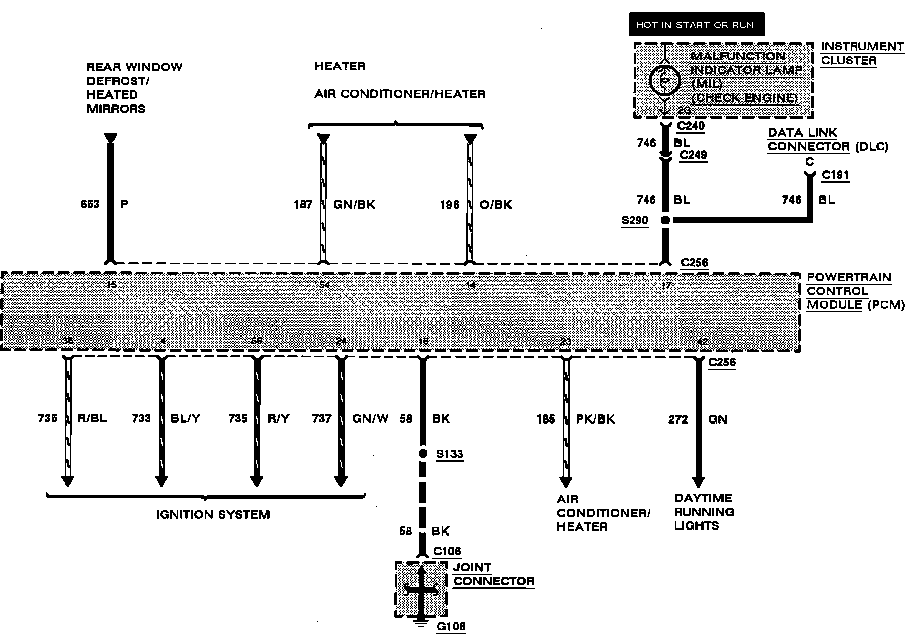

DATA LINK CONNECTOR
MALFUNCTION INDICATOR LAMP
