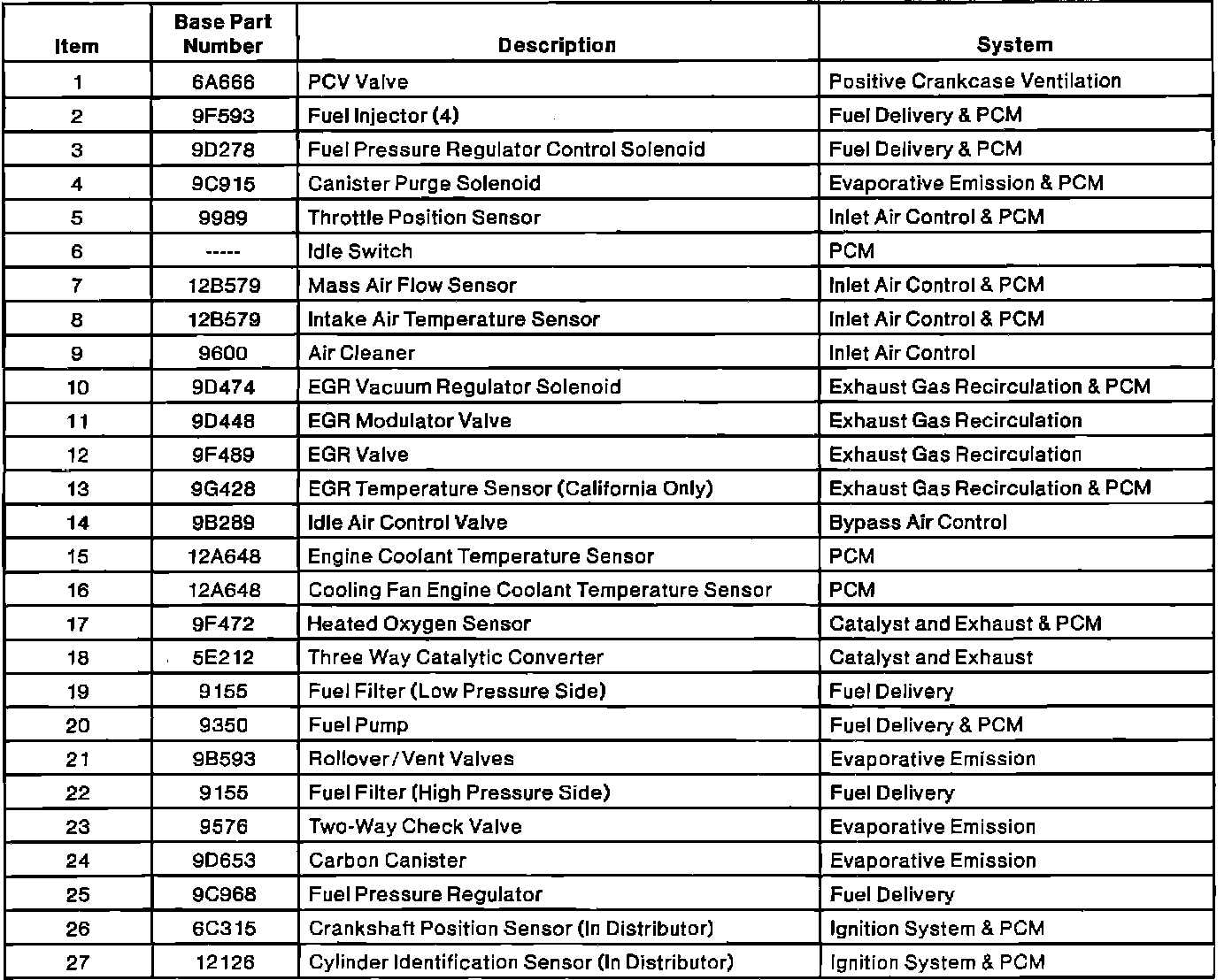

Automatic Transaxle
Emission Related Systems:
Component ID:
SUMMARY
