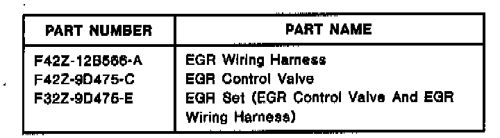

When replacing the EGR valve, install an EGR wire harness jumper to connect the vehicle harness to the new EGR valve.
Parts Block
