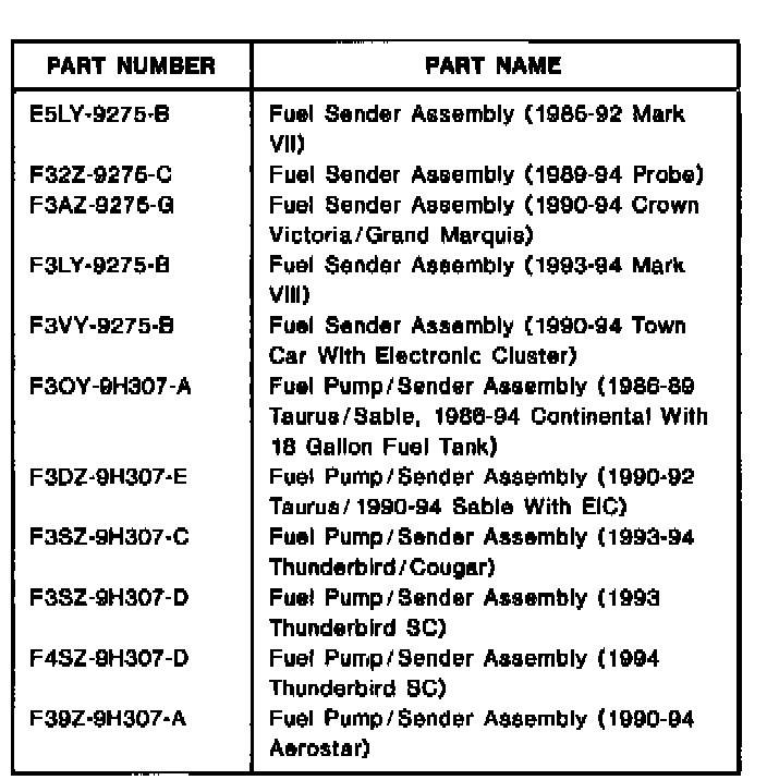

Install a revised sender assembly or fuel pump/sender assembly. Refer to the appropriate vehicle Service Manual, Fuel System Section, for removal and installation procedures. Refer to the Parts Block in this article for correct parts usage.

DEALER CODING
BASIC PART NO. CONDITION CODE
9275/9H307 G25
