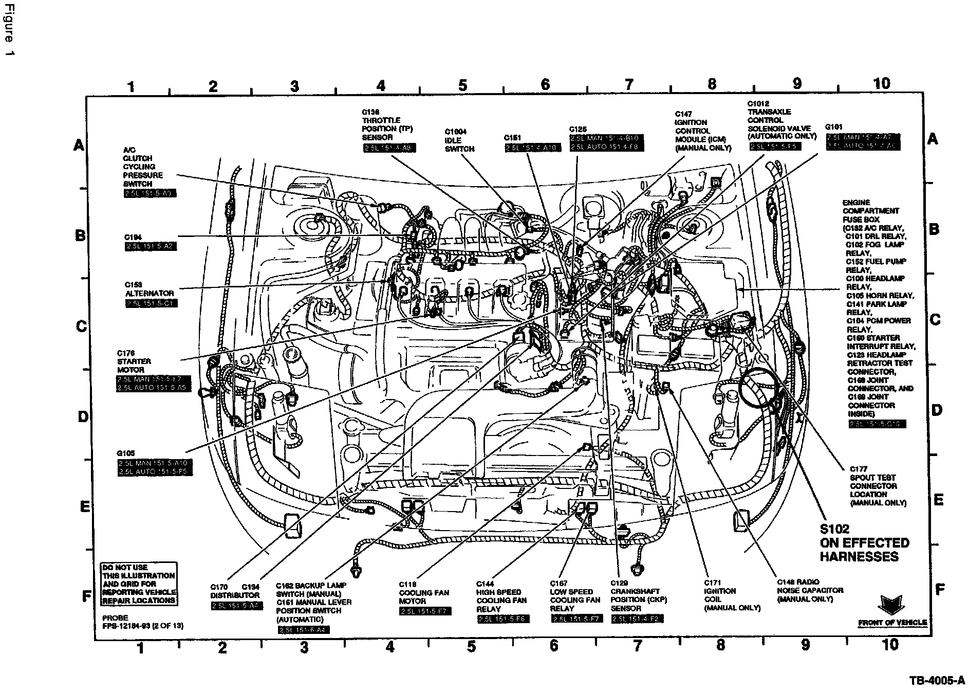

Some vehicles may be hard to start or may not start, or the Fuel Shutoff Lamp may illuminate. This may be caused by corrosion or a short-to-ground at Splice 102 (Circuit 9).
ACTION:
Inspect Splice 102 (see Figure 1) for corrosion or short-to-ground and, if necessary, repair the splice. Cover with self-sealing heat shrink tubing. This repair will minimize future shorts/corrosion at the splice. Refer to the following Service Procedure for details.

3. To inspect, remove the left headlamp assembly to gain access to the harness.
Locate Splice 102 in the engine compartment under the left headlamp assembly in the main harness.
