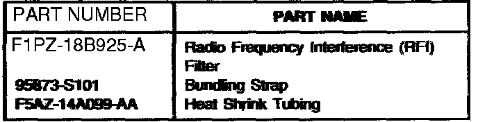

Install an electronic noise Radio Frequency Interference (RFI) Filter (F1PZ-18B925-A) on the fuel pump inside the fuel tank. Refer to the following Test Procedure to confirm that the concern exists, then refer to the Service Procedure for repair details.

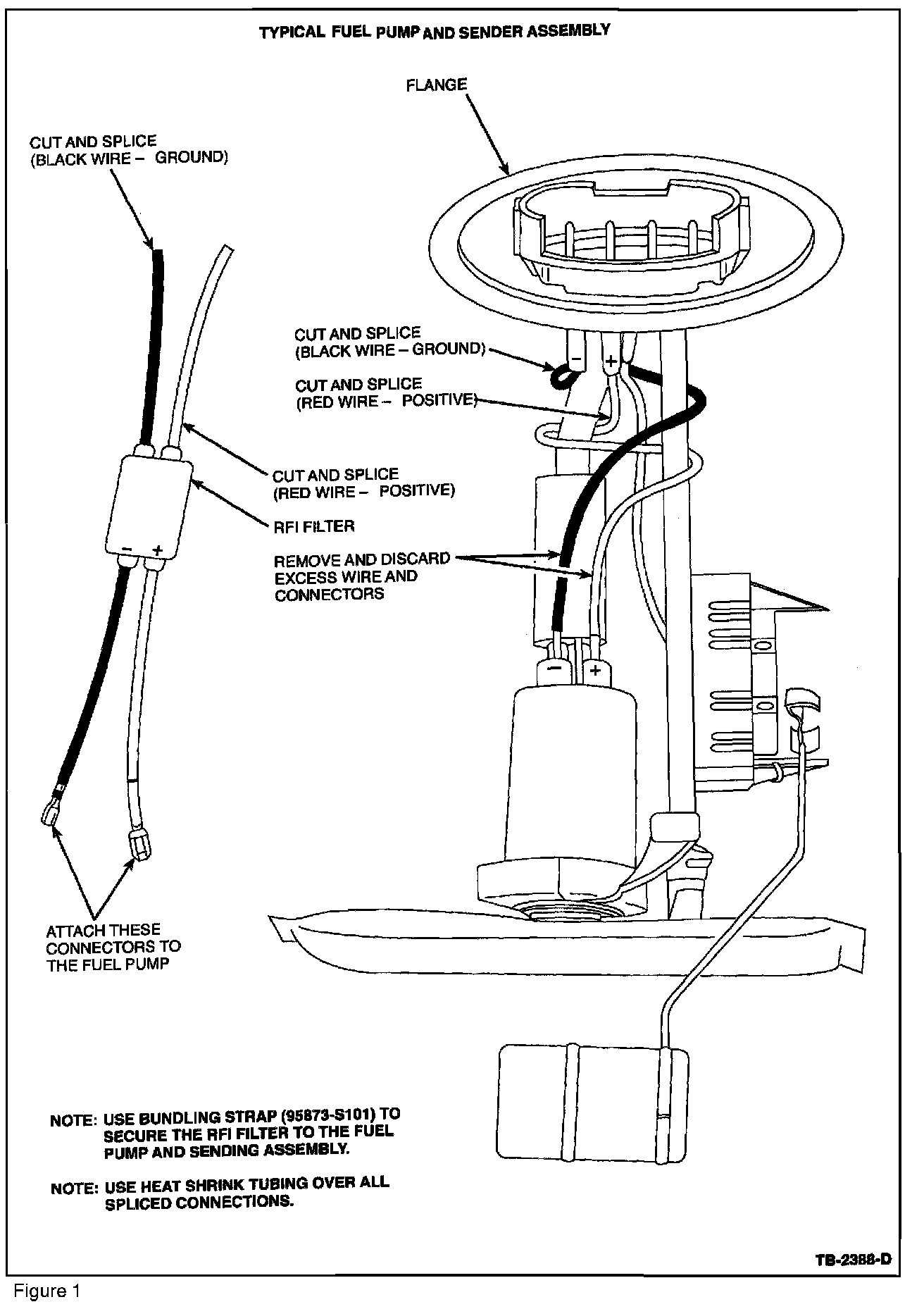

2. On vehicles without a fuel delivery module, remove the negative and positive connectors from the fuel pump, Figure 1.
a. Cut the wires to the fuel pump 76 mm (3") from the flange of the fuel pump and discard the wires.
b. Connect the RFI filter connectors to the spade terminal on the fuel pump.
c. Cut and solder both the red and black wires of the RFI filter to the red and black wires of the flange. Use Heat Shrink Tubing (F5AZ-14A099-M) over the solder connections.

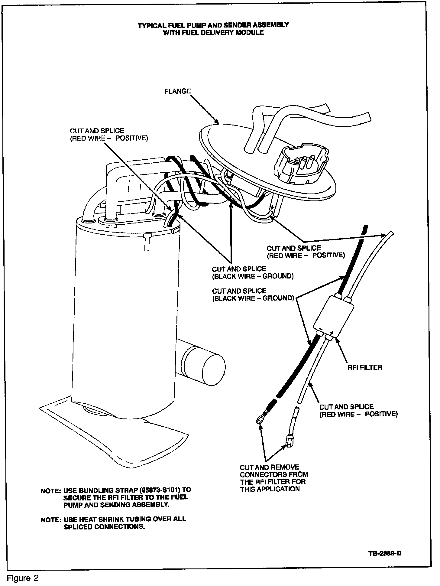

3. On light trucks and compact trucks with a fuel delivery module, cut the fuel pump wires to the fuel delivery module 50 mm (2") from the flange and discard the wires, Figure 2.
a. Cut the connectors from the RFI filter and solder wires to the fuel delivery module (red to red and black to black). Use heat shrink tubing over soldering connections.
b. Solder wires from the RFI filter to the flange wires (red to red and black to black). Use heat shrink tubing over soldered connections.
NOTE:
HEAT SHRINK TUBING MUST BE USED OVER ALL SOLDERED CONNECTIONS MADE PRIOR TO THIS TSB. USE SUFFICIENT TUBING (ABOUT 50 mm (2")) OF THE SPECIFIED TYPE TO ENTIRELY COVER EACH SOLDERED CONNECTION AND SHRINK APPROPRIATELY TO PREVENT EXPOSURE OF THE CONNECTIONS.
NOTE:
FOR SOME VEHICLES WITH EXTREMELY LONG FUEL PUMP GROUND WIRE CIRCUITS, IT MAY BE NECESSARY TO SHORTEN THE WIRE TO A POINT CLOSE TO THE FUEL TANK IF THE GROUND IS MOVED, BE SURE IT IS SECURE AND PROTECTED FROM CORROSION. SINCE IT IS THE OPERATING GROUND FOR THE PUMP. CHECK SERVICE LITERATURE (EVTM, ETC.) FOR GROUND LOCATIONS.
WARNING
ALL SOLDERING AND HEAT SHRINKING MUST BE COMPLETED AWAY FROM THE FUEL TANK AREA. USE A SOLDERING IRON ONLY FOR SOLDERING AND HEAT GUN ONLY FOR APPLYING SHRINK TUBING.
4. Secure the RFI filter to the fuel pump and sender assembly with a Bundling Strap (95873-S101) to prevent rattling in the tank, Figures 1 and 2.
