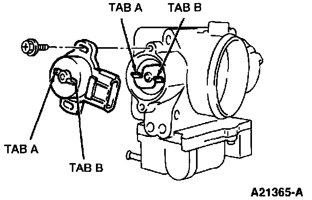

Throttle Position Sensor:
THROTTLE POSITION SENSOR ADJUSTMENT
NOTE: If the voltage is not within specifications, adjust the Throttle Position Sensor (TP) as follows:
1. Loosen the TP sensor set screws.
2. With the throttle valve fully closed, rotate the TP sensor until the voltage is 0.1-1.1 volts.
3. With the throttle valve fully open, verify that the voltage is 3.1-4.4 volts.
4. Tighten the TP sensor set screws to 2 Nm (14-20 in lb).
