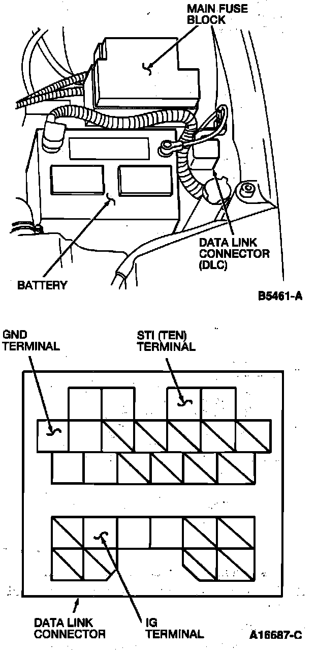

Data Link Connector:
1. Warm engine to operating temperature.
2. Turn all electrical loads "OFF."
3. Connect Rotunda Digital Tachometer (059-00007), or equivalent.
4. Connect timing light.
5. Connect Data Link Connector terminals STI (TEN) and GND with jumper wire.
6. Verify correct idle speed. Adjust if needed:
IDLE SPEED: 700 ± 50 rpm
Timing Marks:
7. Check timing:
TIMING: 12° ± 1° BTDC
8. If not correct, loosen hold-down bolts and turn distributor to adjust.
9. Tighten hold-down bolts:
TORQUE: 14 - 18 ft lb (19 - 25 Nm)
10. Remove test equipment and jumper wire.
