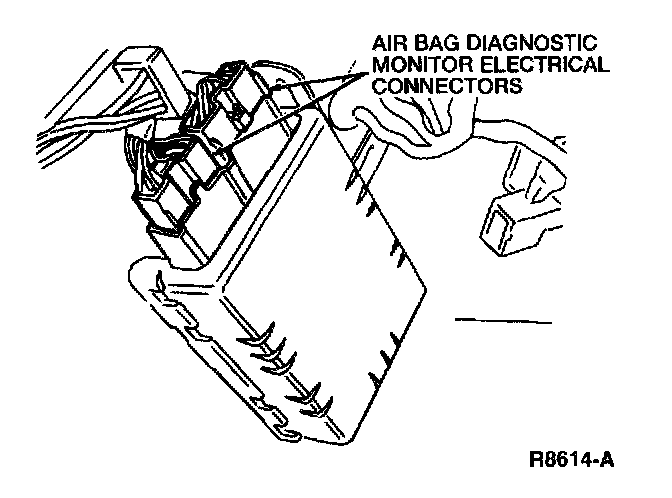

RemovalWARNING: THE BACKUP POWER SUPPLY ENERGY MUST BE DEPLETED BEFORE ANY AIR BAG COMPONENT SERVICE IS PERFORMED. TO DEPLETE THE BACKUP POWER SUPPLY ENERGY, DISCONNECT THE NEGATIVE BATTERY CABLE AND WAIT ONE MINUTE.
NOTE: The air bag diagnostic monitor has a blue casing and is located underneath the driver's side of the instrument panel near the speed control module.
1. Disconnect the negative battery cable and wait one minute for the backup power supply energy to be depleted.
2. Disconnect the two air bag diagnostic monitor electrical connectors.
3. Slide the air bag diagnostic monitor out of the mounting bracket.
Installation
To install, reverse the removal procedure. Verify that the air bag lamp is operative.
