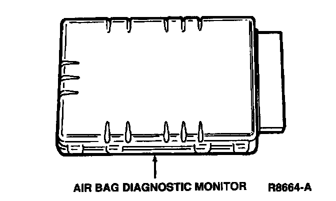

Air Bag Control Module: Description and Operation
The air bag diagnostic monitor continually monitors all air bag system components and wiring connections for possible faults in the system. If the diagnostic monitor detects a fault in the air bag system when the ignition switch is in the ON position, a fault code will be displayed on the air bag lamp, located in the instrument cluster. Performing system diagnostics is the main purpose of the diagnostic monitor.
The air bag diagnostic monitor does not deploy the air bag in the event of a crash. The crash sensors are "hard wired" to the air bag, therefore, the crash sensor and safing sensor determine when to deploy the air bag.
Features and functions of the air bag diagnostic monitor include:
