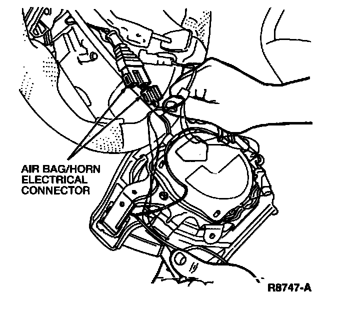

3. Disconnect the air bag/horn electrical connector.

1. Connect the air bag/horn electrical connector.
