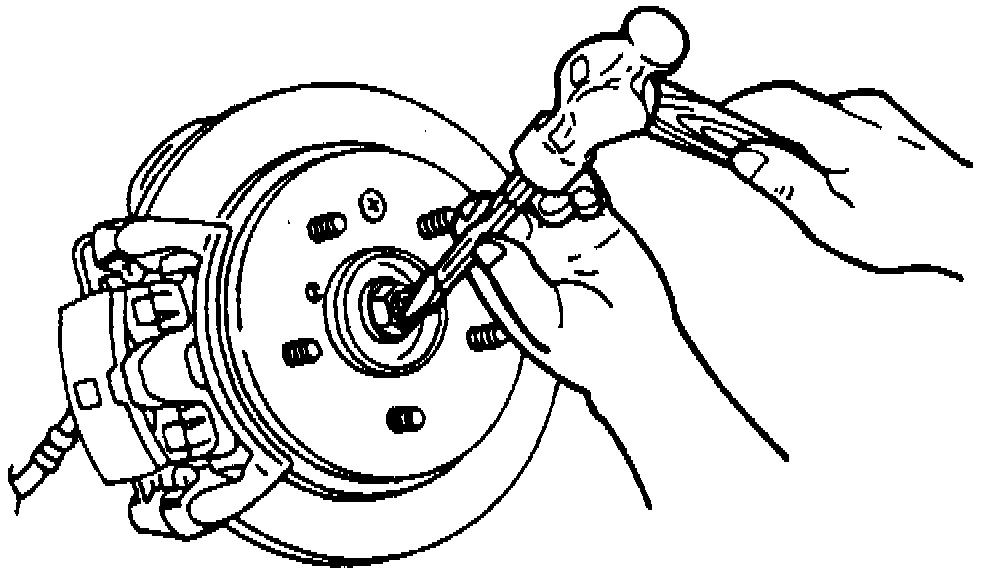

Fig. 1 Halfshaft Attaching Nut Stake Removal:
3. Carefully raise staked portion of halfshaft attaching nut using a small cape chisel.
4. Remove halfshaft attaching nut. When loosening nut, lock hub in position by having a helper lock brakes.

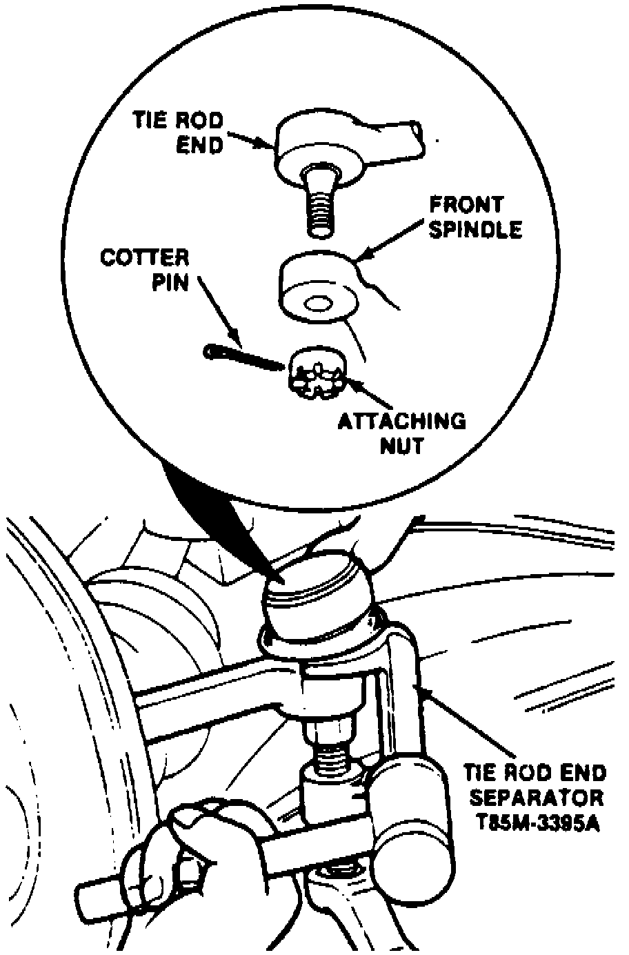

Fig. 2 Separating Tie Rod End From Steering Knuckle:
6. Separate tie rod end from steering knuckle.

11. Use tie rod end remover tool No. 3290-D, or equivalent, to separate tie rod end from steering knuckle arm.

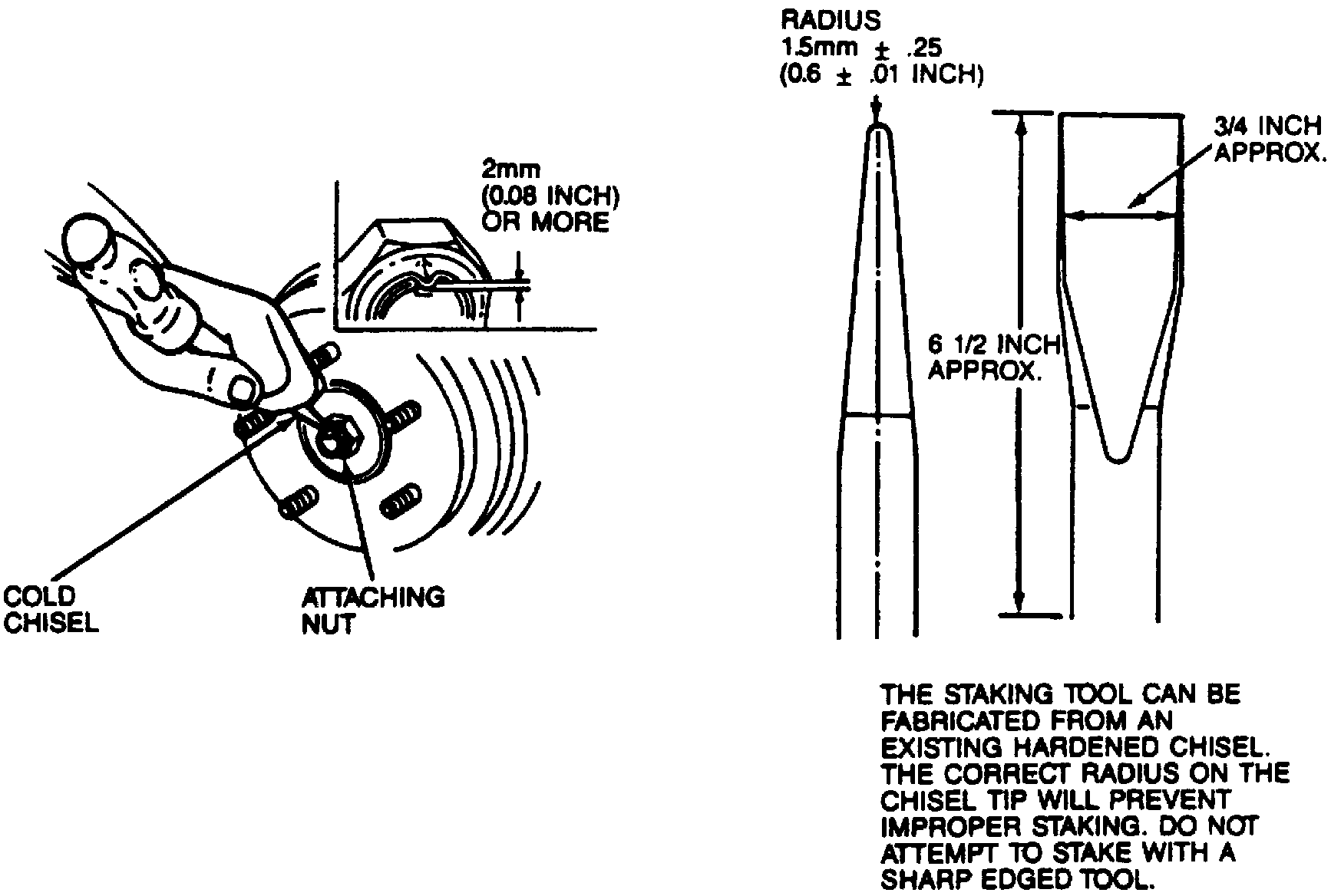

Fig. 4 Staking Halfshaft Attaching Nut:
15. Reverse procedure to install. Tighten axle nut to 174-235 ft lb, then stake nut. Tighten tie rod end attaching nut to 22-33 ft lb.
