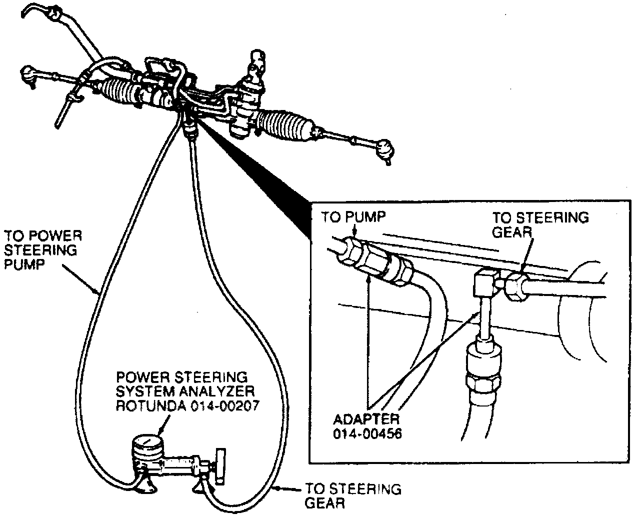

Fig. 2 Connecting Rotunda Power Steering System Analyzer:
3. Attach Rotunda power steering system analyzer 014-00207 with adapter 014-00456, or equivalents, between pressure hose connection as shown. Torque fittings to 29-36 ft lb.
