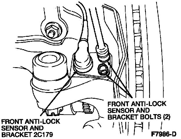

Front Anti-Lock Sensor And Bracket.:
6. Remove the two front anti-lock sensor and bracket bolts.

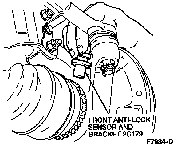

Front Anti-Lock Sensor And Bracket:
7. Remove the front anti-lock sensor and bracket.

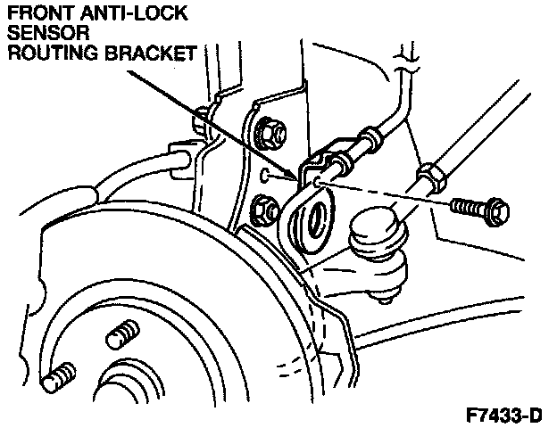

Anti-Lock Sensor Bracket:
8. Remove the front anti-lock sensor routing bracket bolt.
