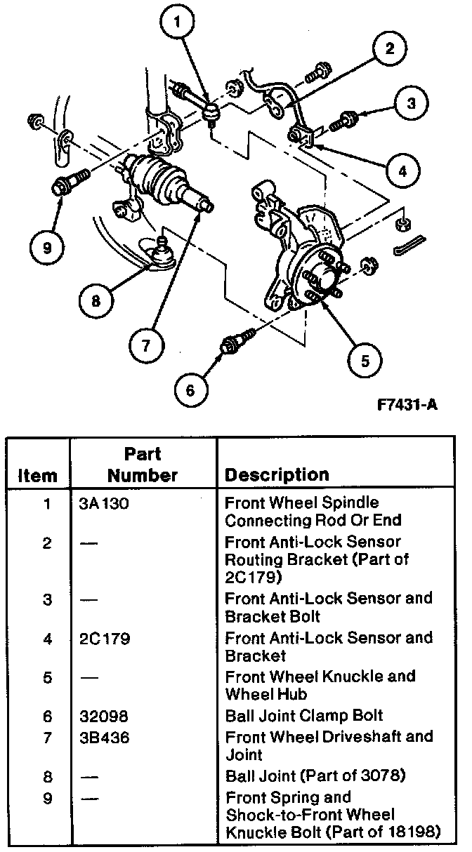

Wheel Hub, Wheel Knuckle, And Wheel Bearing:

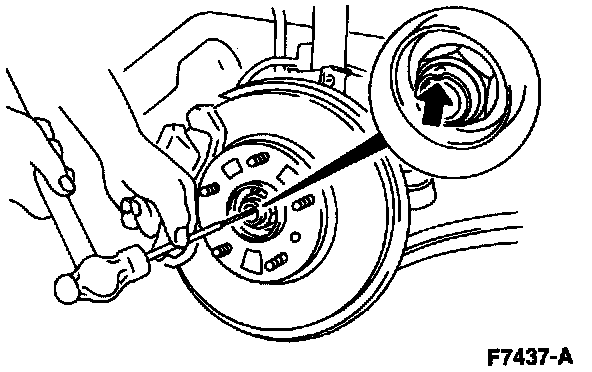

Wheel Hub Retainer:
3. Carefully raise the staked portion of the front axle wheel hub retainer using a small cape chisel.
NOTE: When loosening the front axle wheel hub retainer, lock the wheel hub by applying the brakes.
4. Remove the front axle wheel hub retainer. Discard the retainer. It must not be reused.

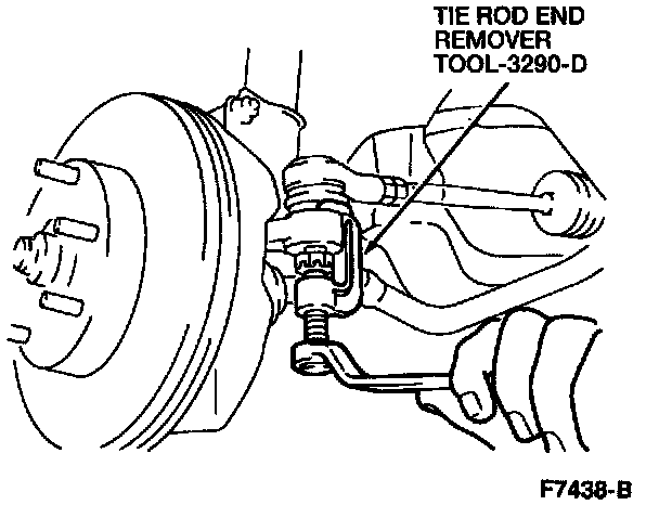

Tie Rod End Remover Tool:
6. Use tie Rod End Remover TOOL-3290-D or equivalent to separate the front wheel spindle connecting rod or end from the front wheel knuckle.

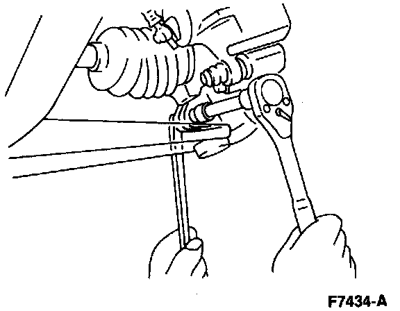

Ball Joint Clamp:
7. Remove the bolt joint clamp bolt.
Ball Joint And Wheel Knuckle:

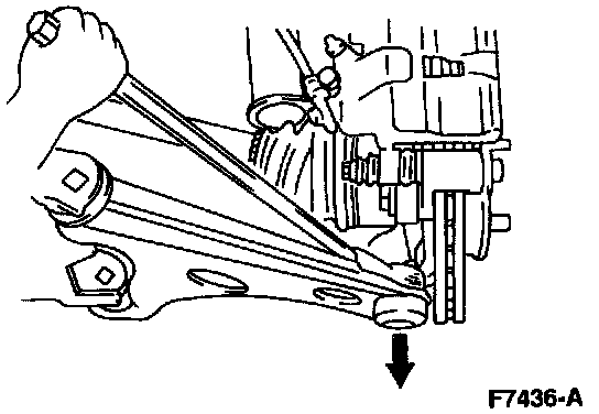

8. Separate the ball joint from the front wheel knuckle.

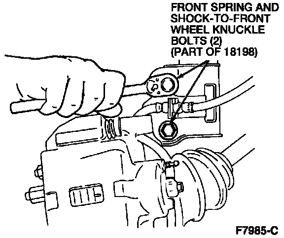

Spring And Shock To Wheel Knuckle:
9. Remove the two front spring and shock-to-front wheel knuckle bolts.
NOTE: If the wheel hub binds on the front wheel drive shaft and joint splines, it can be loosened by lightly tapping with a plastic faced hammer on the end of the front wheel driveshaft and joint.
10. Separate the front wheel knuckle from the front wheel driveshaft and joint.
11. Remove the front wheel knuckle.
