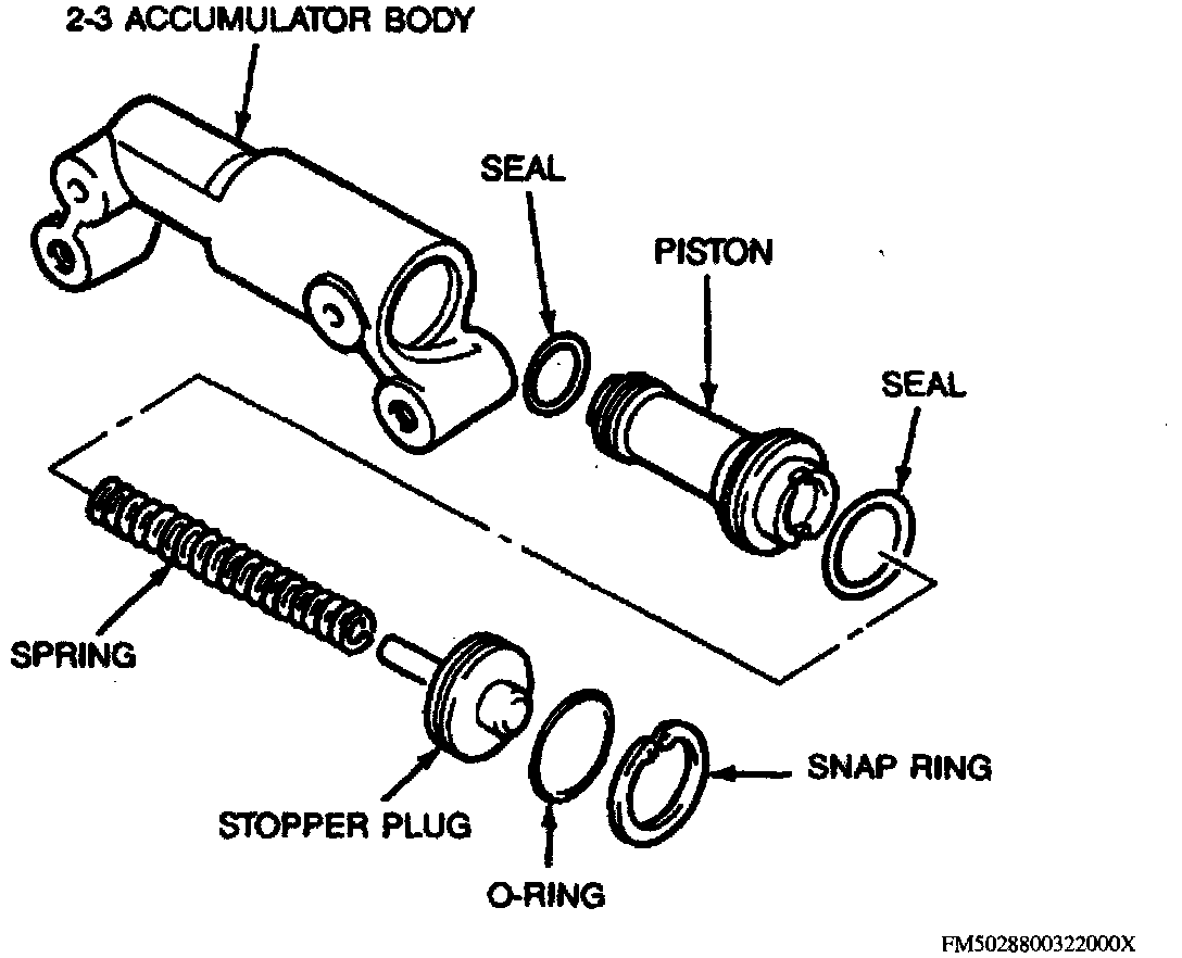

DISASSEMBLEExploded View Of 2-3 Accumulator:
NOTE: Refer to the Exploded View Of 2-3 Accumulator image when disassembling the 2-3 accumulator.
