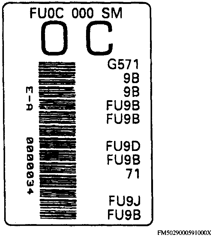

IDENTIFICATIONVehicle Certification Label:
All vehicles are equipped with a vehicle certification label affixed to the lefthand door jamb below the latch striker. Refer to the code below the space marked TR.
Transaxle Identification Tag:
For additional information, such as model, service ID level, or build date, refer to the Transaxle Identification Tag. The transaxle identification tag is located on the transaxle case.
