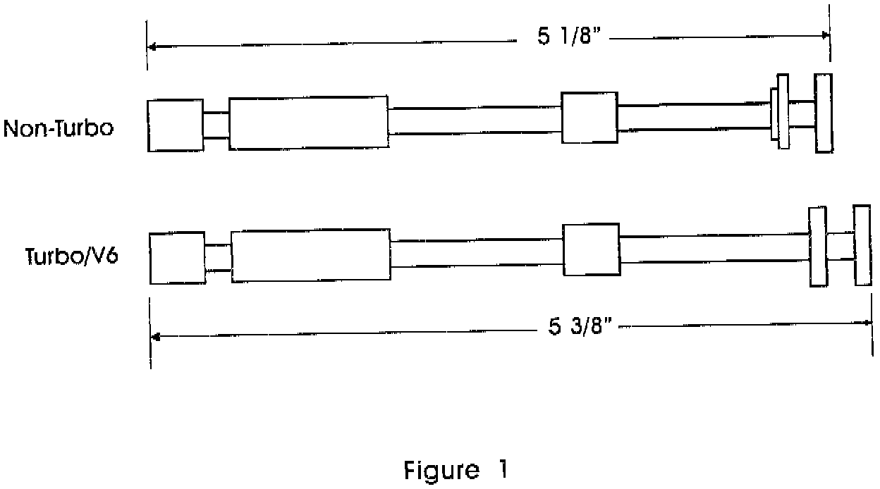

These symptoms may be caused by installing a manual valve of the wrong length. Complete valve body assemblies can be installed in any application, however, the manual valve must match the case. Non-turbo cases use a manual valve length of 5 1/8 inches, the turbo and V-6 cases use a manual valve that is 5 3/8 inches in length (figure 1).
