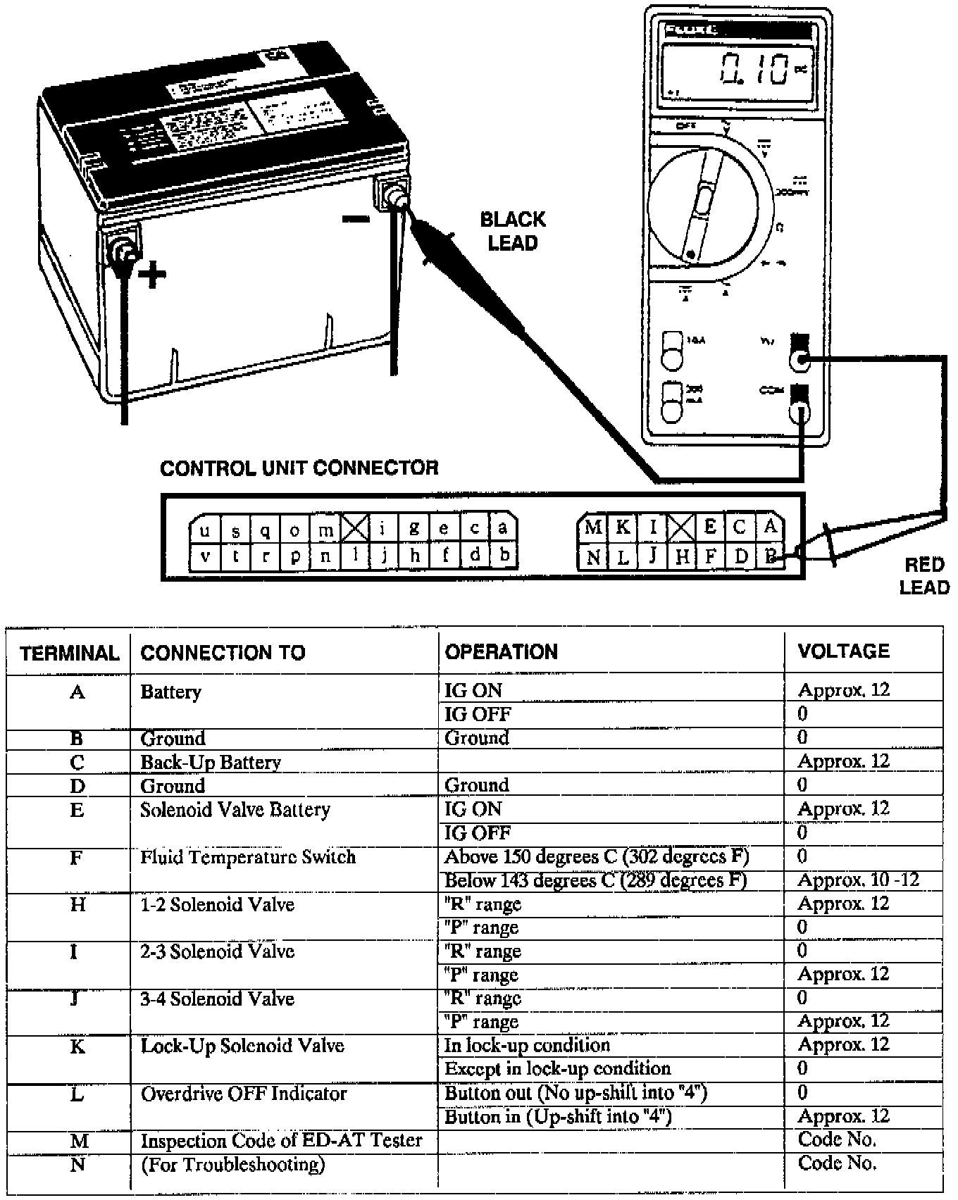

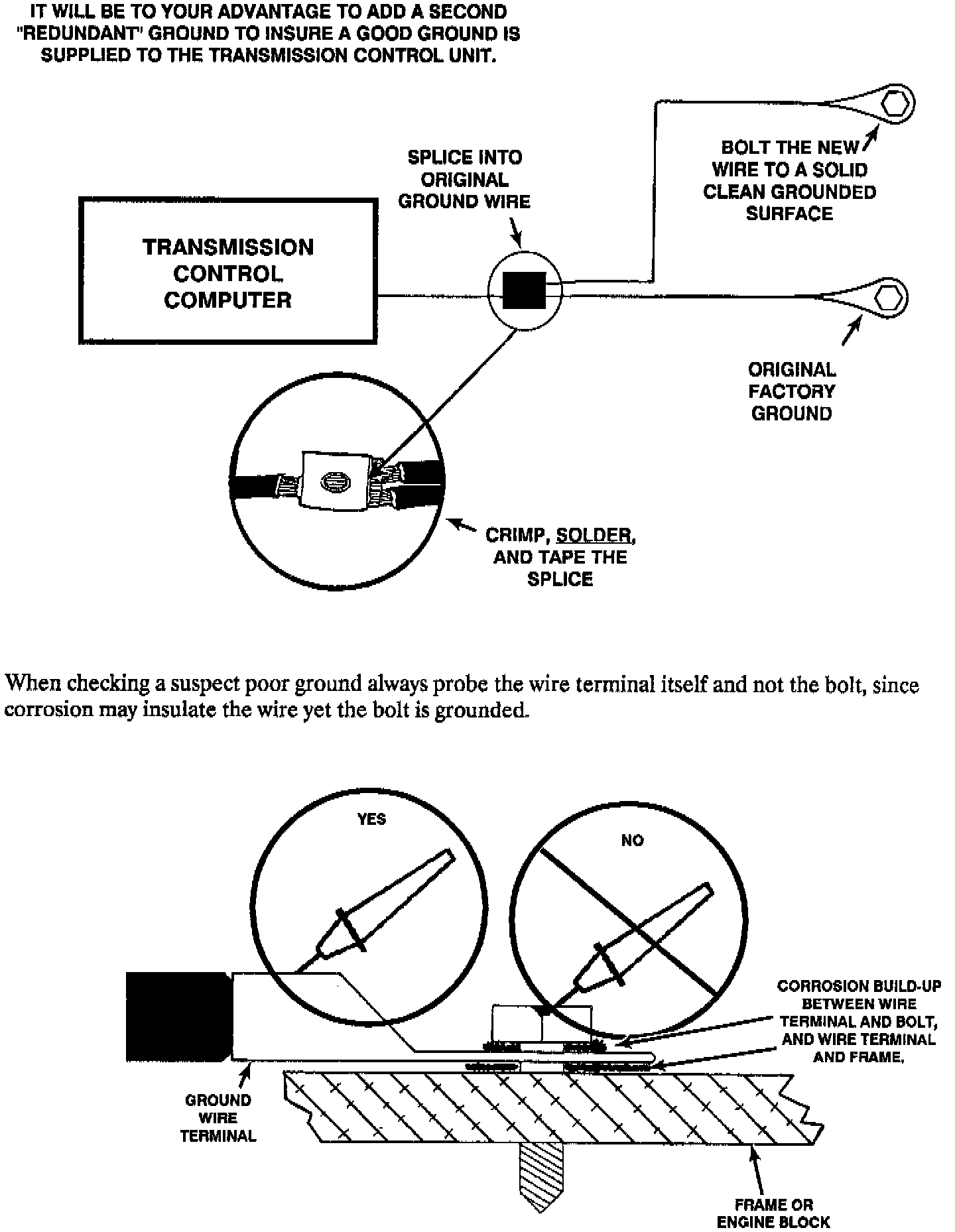

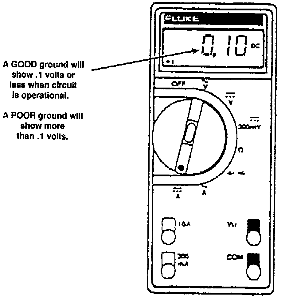

To test for a poor ground, connect the black lead of your digital voltmeter directly to the negative battery post and probe the suspect ground wire with the positive lead. A good ground will read 0.1 volts or less. More than 0.1 volts is a poor ground. Keep in mind the circuit must be operating to accurately check the ground.
Using a service manual for the vehicle you are working on, locate the transmission computer ground circuit. In the example shown, B and D are the grounds. Now with the vehicle running in gear, backprobe B and D with the positive lead. Make sure the negative lead is hooked directly to the NEGATIVE BATTERY POST. The voltmeter must read 0.1 or less.
