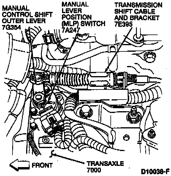

2. Remove the engine air cleaner.
Manual Lever Position Switch:
3. Remove the transmission shift cable and bracket from the manual control shift outer lever. Use a screwdriver or suitable tool to pry the transmission shift cable from the manual control shift outer lever.

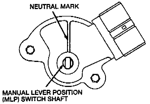

5. Rotate the MLP switch shaft to the neutral mark.
6. Loosen the MLP switch bolts.

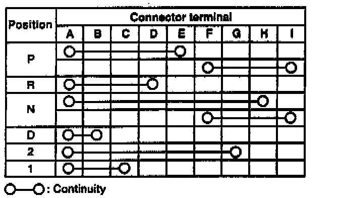

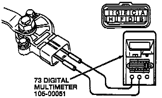

7. Use a Rotunda 73 Digital Multimeter 105-00051 or equivalent and ensure that there is continuity between the terminals.
Use the chart to determine which terminals to check between.
