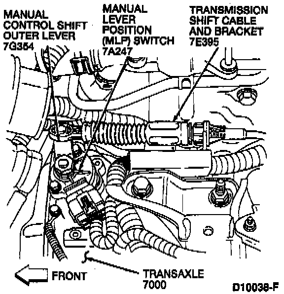

Transmission Position Sensor/Switch: Service and Repair
Manual Lever Position Switch:
REMOVAL
2. Remove the engine air cleaner.
3. Remove the transmission shift cable from the manual control shift outer lever. Use a screwdriver or suitable tool to pry the transmission shift cable and bracket from the manual control shift outer lever.
4. Disconnect the Manual Lever Position (MLP) switch electrical connector.
5. Remove the MLP switch bolts.
6. Remove the MLP switch.
INSTALLATION
1. Install the MLP switch.
2. Adjust the MLP switch.
3. Tighten the MLP switch bolts to 8-10 Nm (71-88 lb in).
4. Connect the MLP switch connector.
5. Install the transmission shift cable and bracket on the manual control shift outer lever.
6. Install the engine air cleaner.
7. Connect the battery ground cable.
