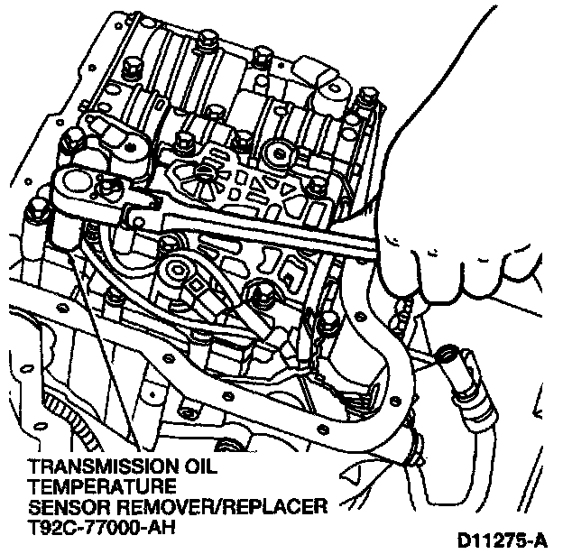

9. Use Transmission Oil Temperature Sensor Remover/Replacer T92C-77000-AH to remove the TOT sensor from the valve body.
Installation
1. Use TOT sensor Remover/Replacer T92C-77000-AH to install TOT sensor to the valve body.
