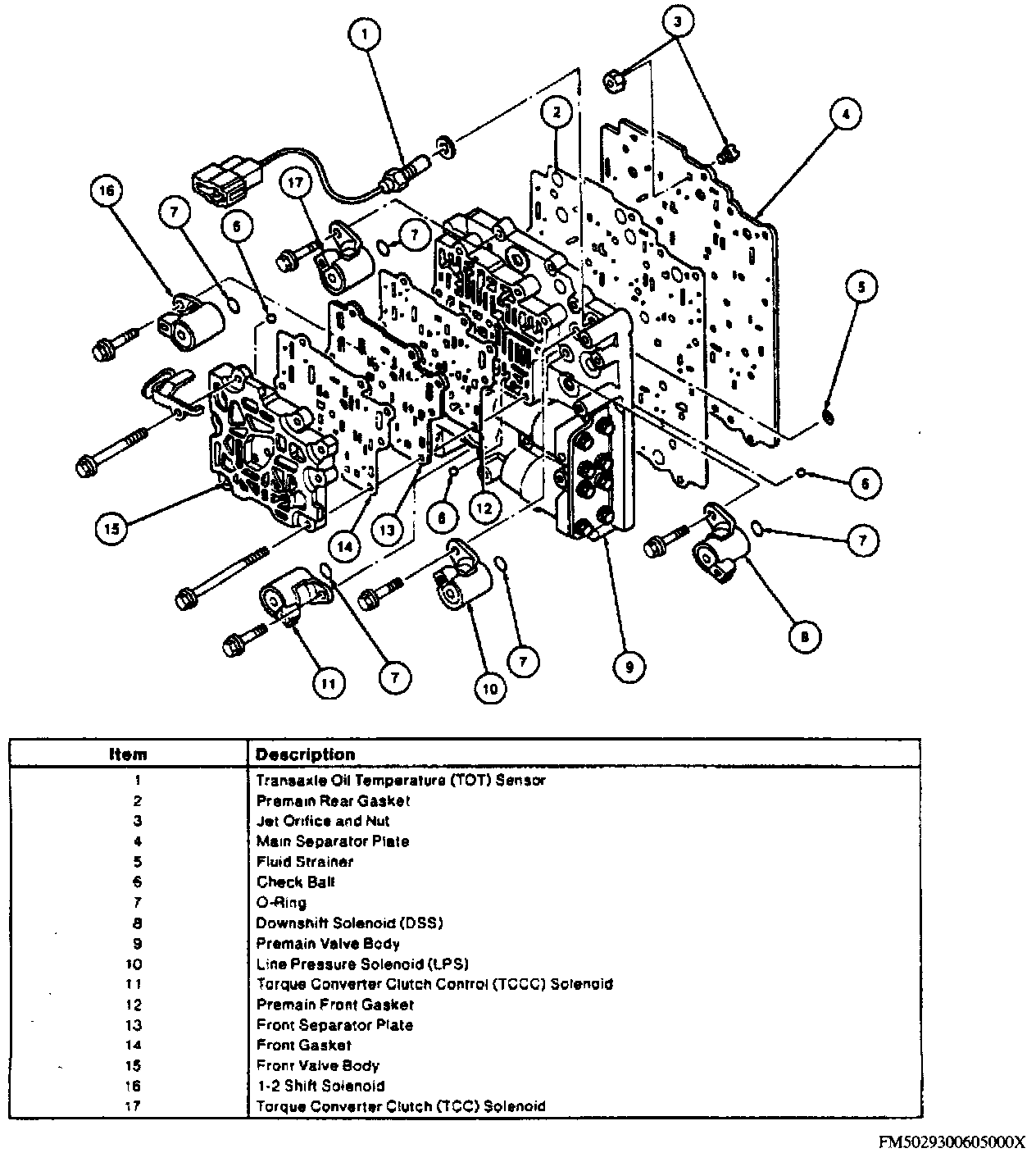

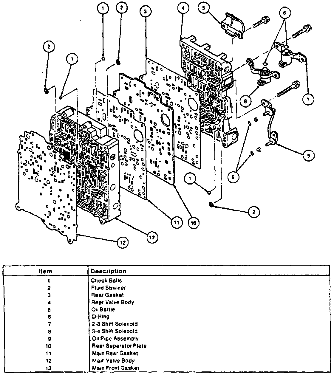

DISASSEMBLEExploded View Of Front And Premain Valve Bodies:
Exploded View Of Main And Rear Valve Bodies:
NOTE: Refer to the Exploded View Of Front And Premain Valve Bodies and the Exploded View Of Main And Rear Valve Bodies during disassembling and assembling procedures.

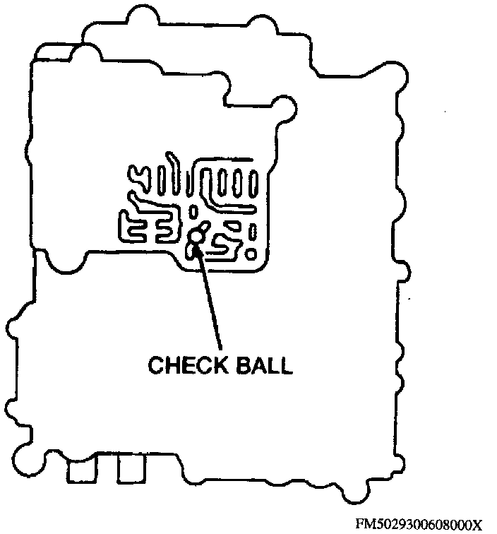

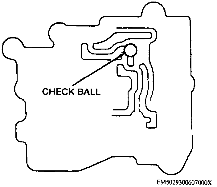

Premain Valve Body Check Ball Location:
7. Remove check ball from premain valve body.

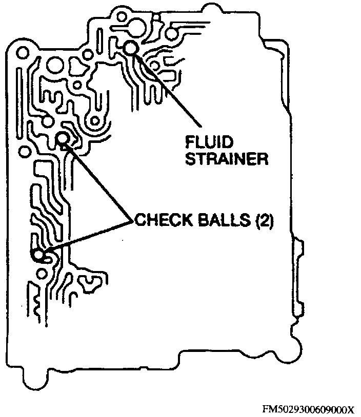

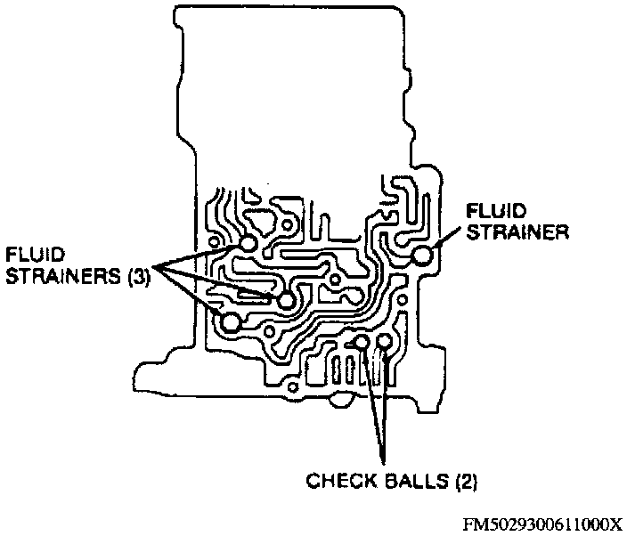

Premain Valve Body Check Ball And Fluid Strainer Locations:
9. Remove jet orifices and nuts from main separator plate, then the two check balls and fluid strainer from premain valve body.

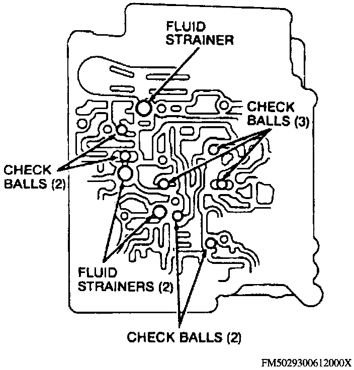

Main Valve Body Check Ball And Fluid Strainer Locations:
10. Remove check ball and fluid strainer from main valve body.

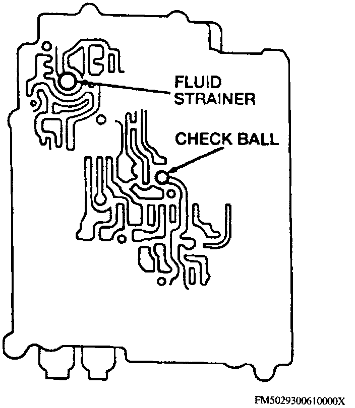

Rear Valve Body Check Ball And Fluid Strainer Locations:
13. Remove rear separator plate and gaskets, then the two check balls and four fluid strainers from rear valve body.
14. Remove seven check balls and three fluid strainers from main valve body.

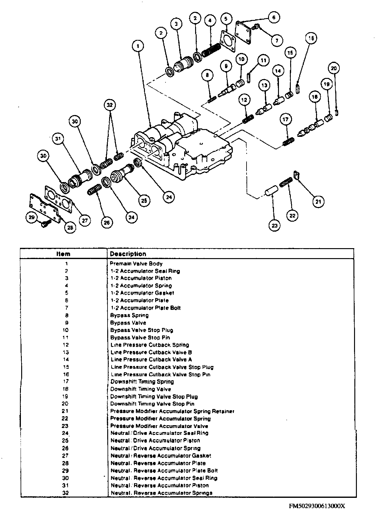

Overhaul Premain Control Body
Exploded View Of Premain Valve Body:
1. Disassemble premain control body as shown.
2. Clean all parts thoroughly in clean solvent as necessary and blow dry with compressed air.
3. Inspect all valve and plug bores for scores and all fluid passages for obstructions.
4. Ensure dry valves and plugs fall from their own weight into their respective bores.

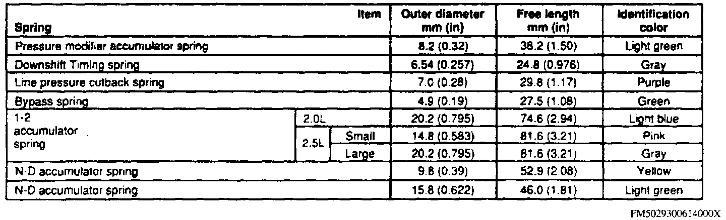

Valve Body Spring Specifications:
5. Inspect and measure all springs for outer diameter and free length.
6. Reverse procedure to assemble, noting the following:
a. Apply automatic transaxle fluid to all parts and bores.
b. Torque neutral/reverse and 1-2 accumulator plate bolts to 58-69 in lbs.

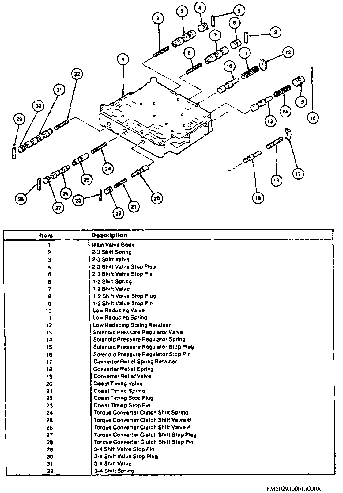

Overhaul Main Control Body
Exploded View Of Main Valve Body:
1. Disassemble main control body as shown in the Exploded View Of Main Valve Body image.
5. Inspect and measure all springs for outer diameter and free length, as shown in the Valve Body Spring Specifications image.
6. Reverse procedure to assemble. Apply automatic transaxle fluid to all parts and bores.

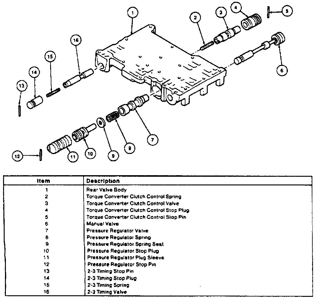

Overhaul Rear Control Body
Exploded View Of Rear Control Body:
1. Disassemble rear control body as shown in the Exploded View Of Rear Control Body image.
5. Roll manual valve on flat surface to check for bent condition. Replace if necessary.
6. Inspect and measure all springs for outer diameter and free length, as shown in the Valve Body Spring Specifications image.
7. Reverse procedure to assemble. Apply automatic transaxle fluid to all parts and bores.
ASSEMBLE
NOTE: Refer to the Exploded View Of Front And Premain Valve Bodies and the Exploded View Of Main And Rear Valve Bodies for assembling procedure.
CAUTION: When assembling valve body, do not mix up front and rear gaskets. Ensure bolt head letter and control valve body letter match.
1. Install three fluid strainers and seven check balls into main valve body and four fluid strainers and two check balls into rear valve body.
4. Install fluid strainer and check ball into main valve body.
5. Install fluid strainer and check ball into premain valve body.
6. Install jet orifices and nuts to main separator plate. Torque jet orifice nuts to 15-19 in lbs.

Front Valve Body Check Ball Location:
9. Install check balls into premain valve and front valve body.
