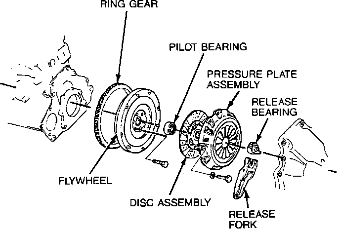

Pressure Plate: Service and Repair
Clutch Assembly:
2. Remove transaxle from vehicle.
3. Install Flywheel Lock tool No. T74P-6375-A or equivalent into transaxle mounting hole on engine, then engage tooth of locking tool into flywheel ring gear.
4. To avoid dropping clutch disc when bolts are removed, use Clutch Aligning tool T74P-7137-K, or equivalent.
5. Remove bolts attaching pressure plate assembly to flywheel, then the pressure plate assembly.
6. Remove clutch disc and aligning tool.
7. Reverse procedure to install.
