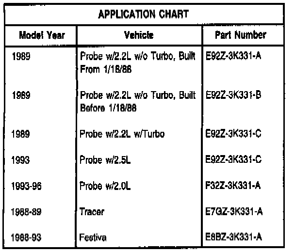

For those instances where the shaft and joint do not require removal, use the new alternate design split boot. When the shaft and joint need removal, use either the original design non-split boot or the new alternate design split boot. Refer to the Application Chart for specific part numbers and the Instruction Sheet included with the CV boot for removal and installation procedures.
PART NUMBER PART NAME
E92Z-3K331-A CV Boot
E92Z-3K331-B CV Boot
E92Z-3K331-C CV Boot
F32Z-3K331-A CV Boot
E7GZ-3K331-A CV Boot
E8BZ-3K331-A CV Boot
