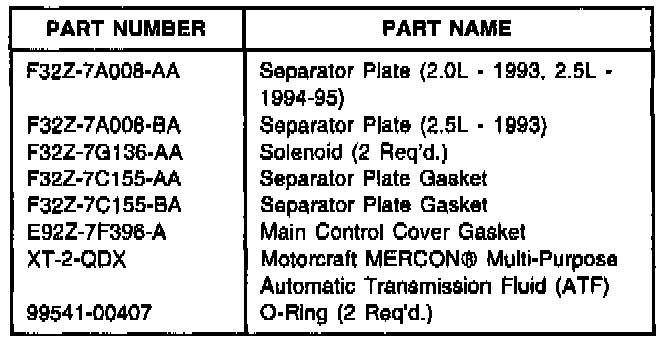

Replace the main control separator plate, Torque Converter Clutch (TCC) solenoid and the line pressure solenoid with a revised plate and solenoids. Refer to the following Diagnostic and Repair Procedures for details.
