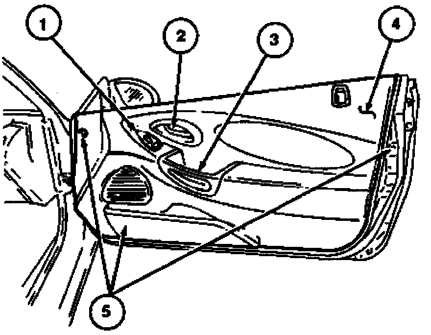

2. Remove the two screws in the bottom of the front door inside pull handle.
3. If equipped, use a suitable tool to remove the regulator handle snap ring and remove the window regulator handle.

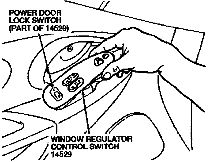

4. If equipped, gently pry up on the window regulator control switch and remove it from the front door trim panel.
5. If equipped, disconnect the window regulator control switch electrical connectors.
6. Remove the inside door handle trim screw.
7. Remove the three front door trim panel screws and push tab.
8. Carefully pull the front door trim panel away from the front door to disengage the clips.
9. Guide the inside door handle through the front door trim panel.
10. Remove the front door trim panel.
