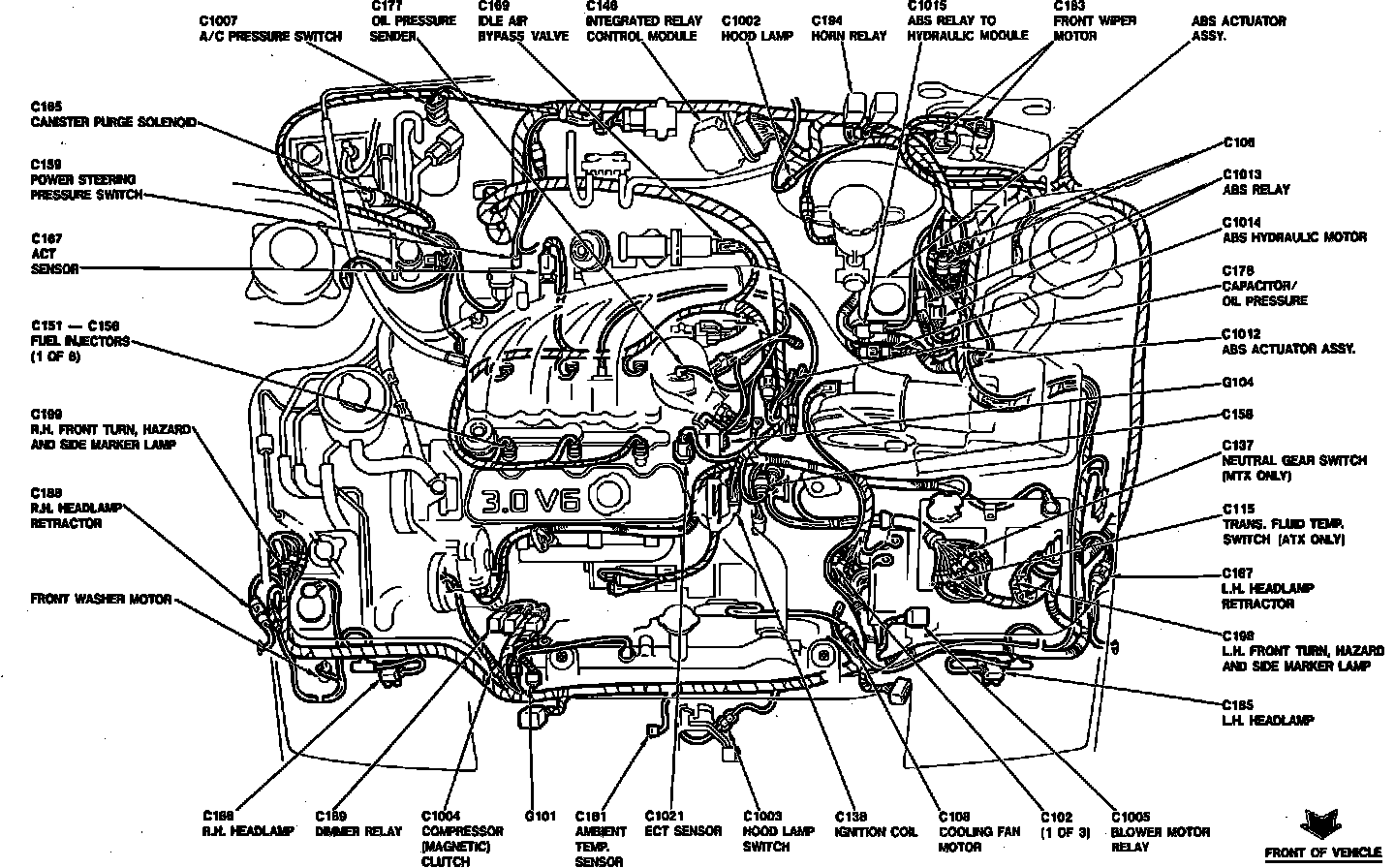

Engine Compartment Component Locations.:
Near Master Cylinder
Applicable to: 3.0L/V6-182
