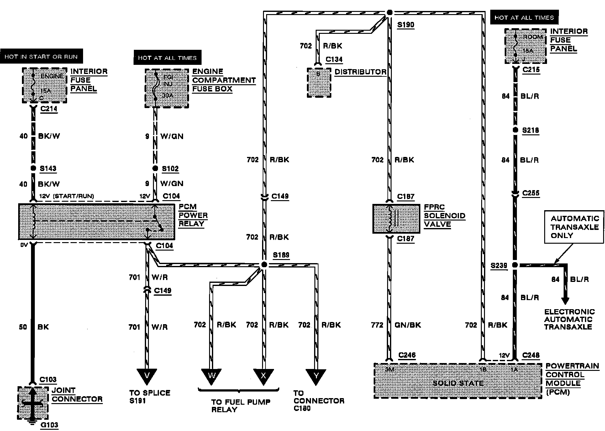

Electronic Engine Control:
DISTRIBUTOR
FPRC SOLENOID VALVE
PCM POWER RELAY
POWERTRAIN CONTROL MODULE (PCM)

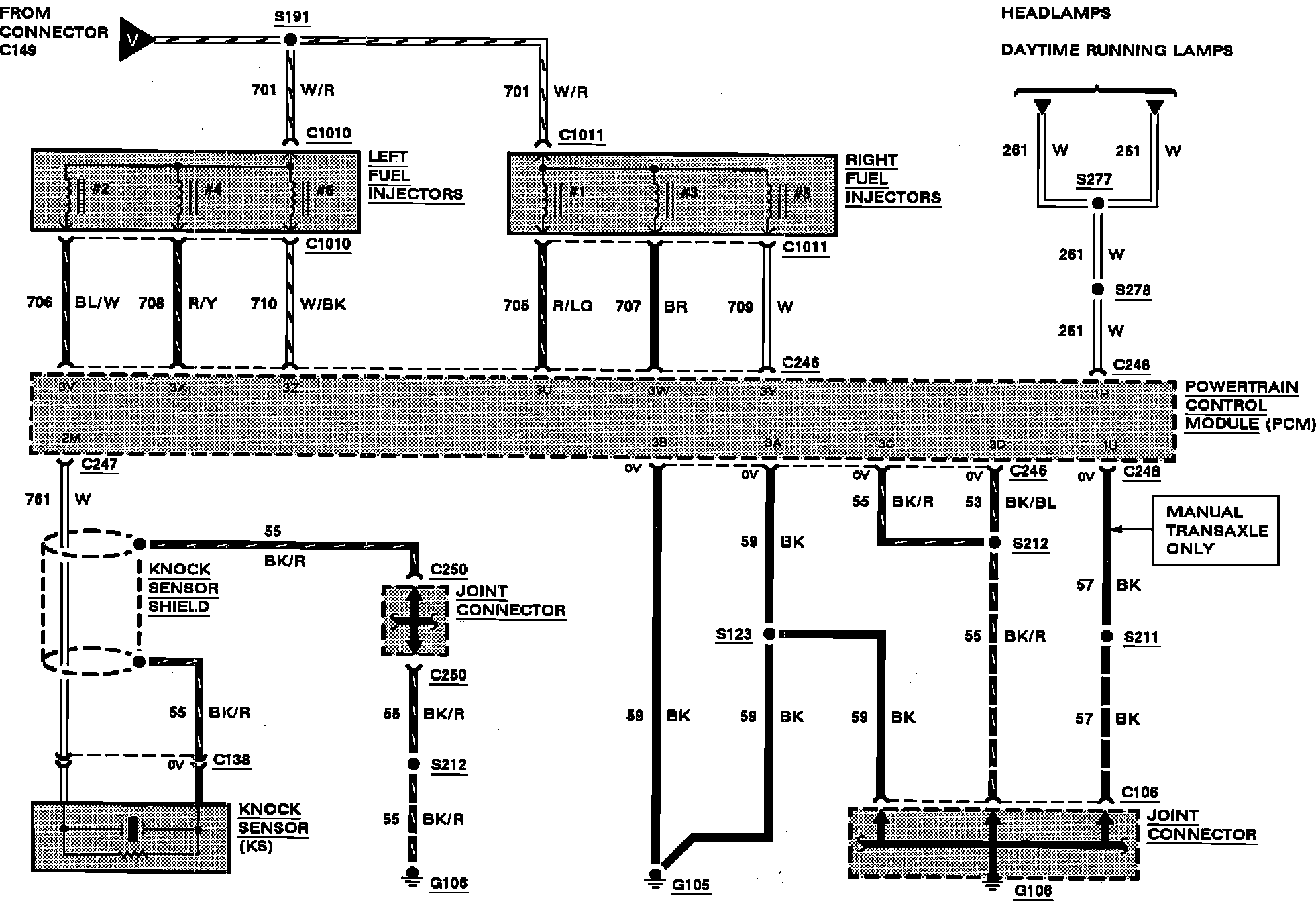

FUEL INJECTORS
JOINT CONNECTOR
KNOCK SENSOR

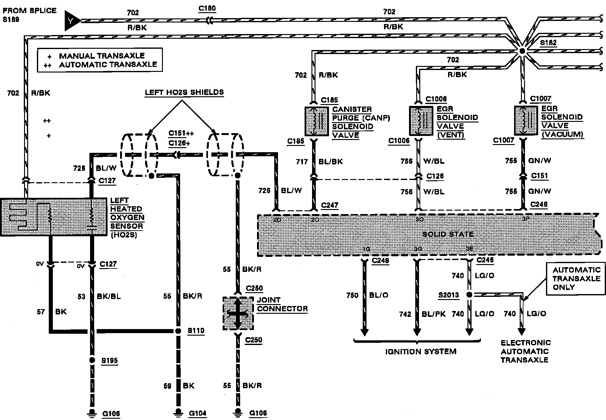

CANISTER PURGE SOLENOID (CANP)
EGR SOLENOID VALVE (VENT)
EGR SOLENOID VALVE (VACUUM)
LEFT HEATED OXYGEN SENSOR (HO2S)

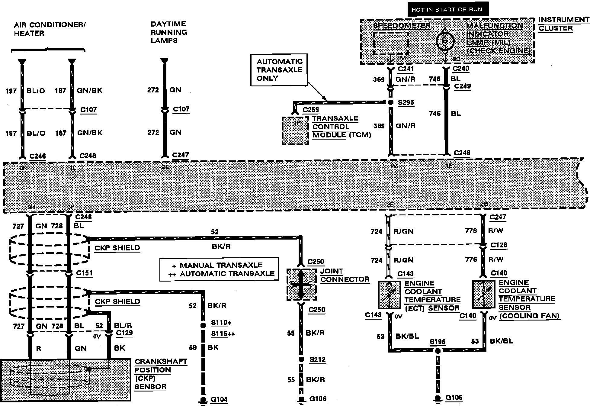

CRANKSHAFT POSITION SENSOR
ENGINE COOLANT TEMPERATURE SENSOR (ECT)
ENGINE COOLANT TEMPERATURE SENSOR (COOLING FAN)
MALFUNCTION INDICATOR LAMP
TRANSAXLE CONTROL MODULE

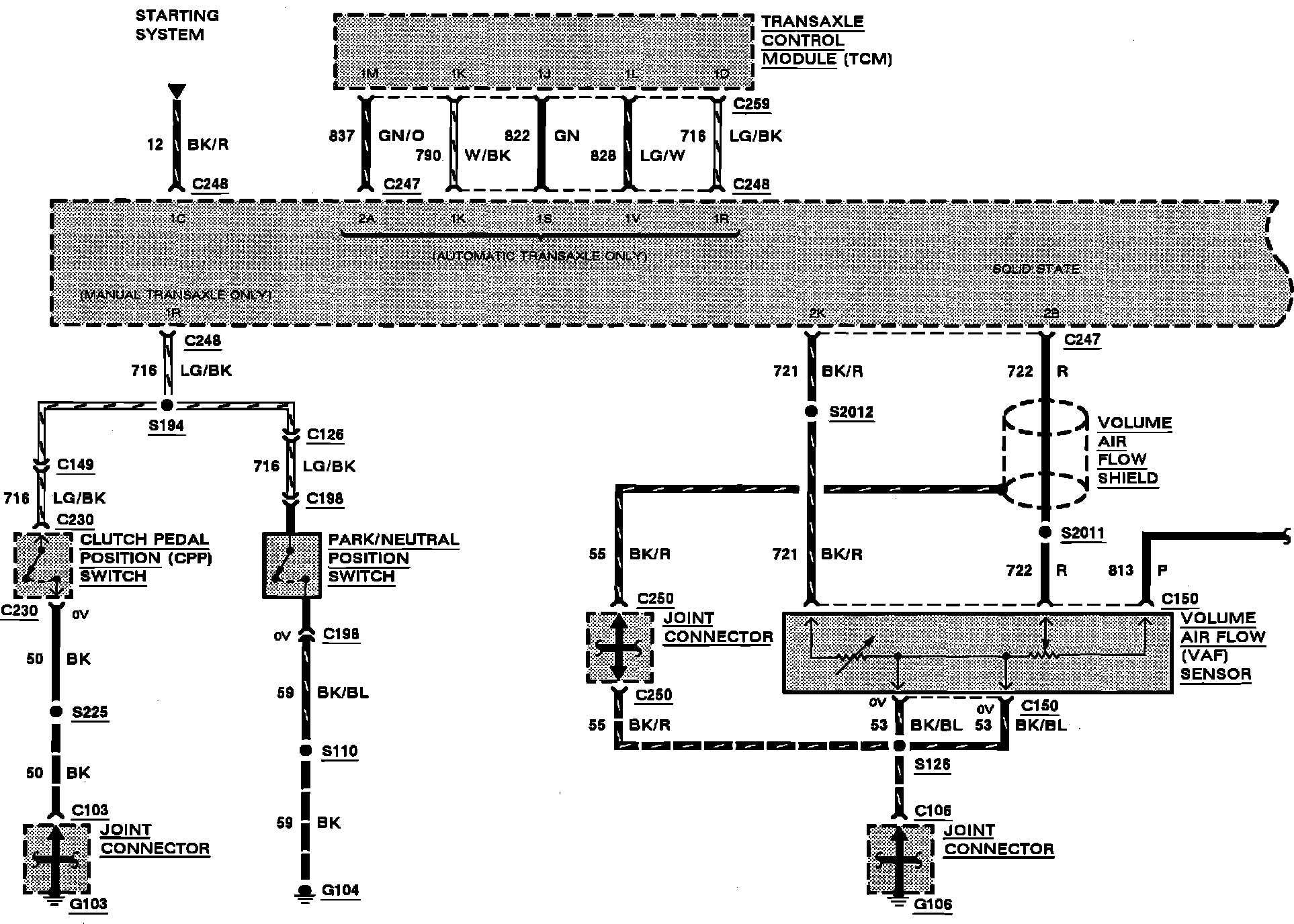

CLUTCH PEDAL POSITION SWITCH
PARK/NEUTRAL POSITION SWITCH
TRANSAXLE CONTROL MODULE (TCM)
VOLUME AIR FLOW SENSOR (VAF)

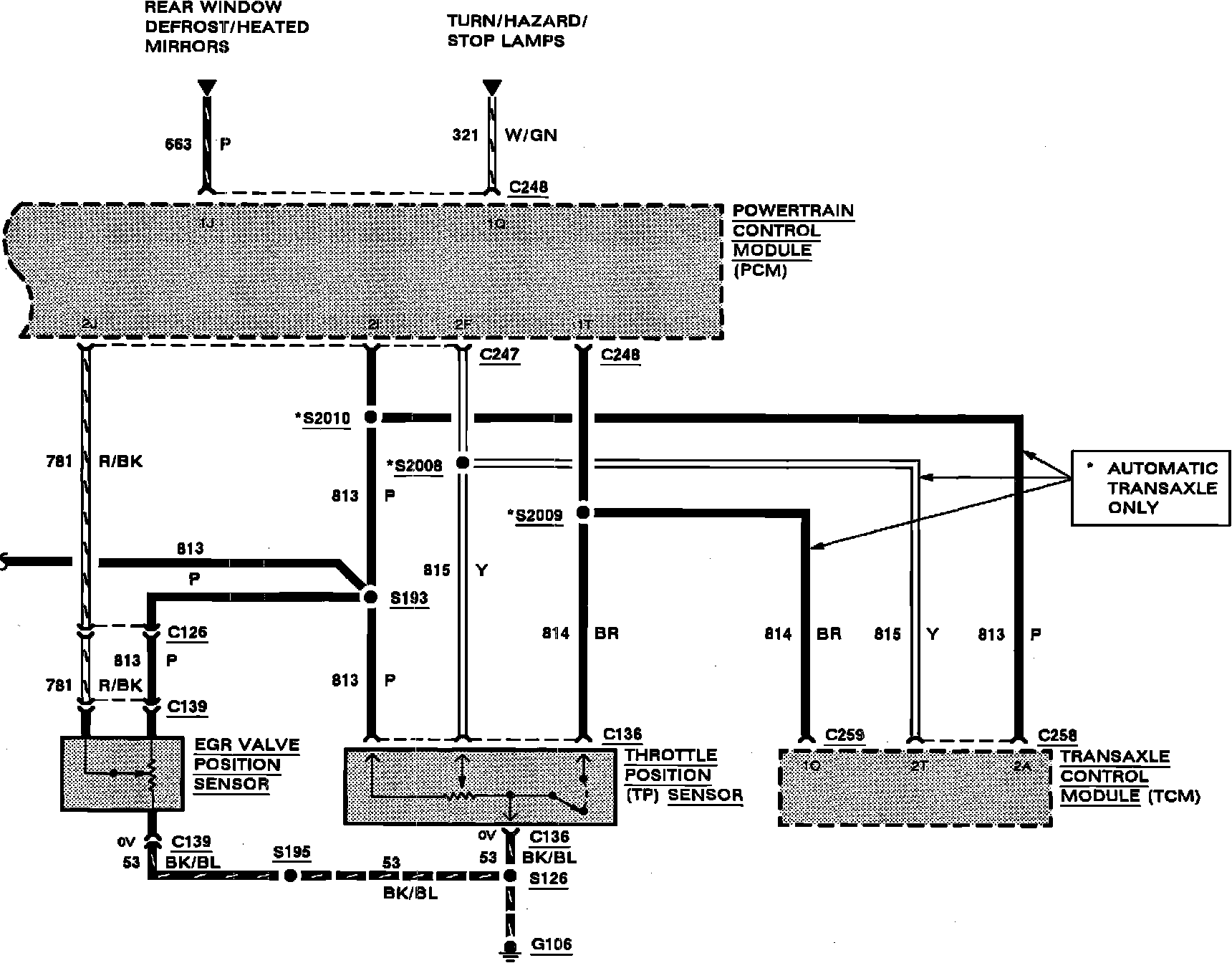

EGR VALVE POSITION SENSOR
THROTTLE POSITION SENSOR (TPS)
