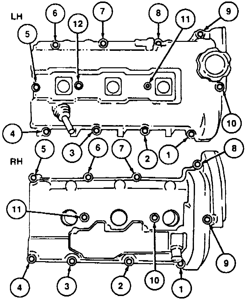

Cylinder Head Cover Bolt Tightening Sequence:
b. Tighten valve cover bolts in sequence in two steps to 45-70 in lb.
