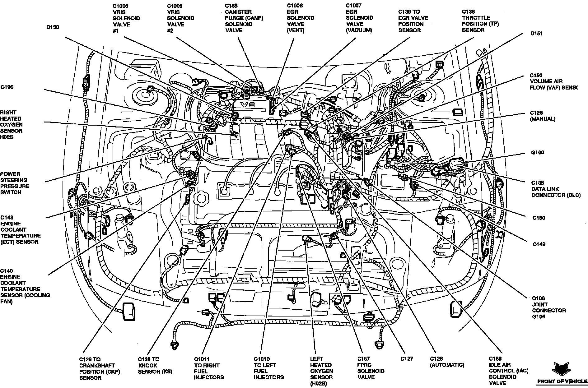

Component Locations:
CANISTER PURGE (CANP) SOLENOID VALVE
CRANKSHAFT POSITION (CKP) SENSOR
DATA LINK CONNECTOR (DLC)
EGR SOLENOID VALVE (VACUUM)
EGR SOLENOID VALVE (VENT)
EGR VALVE POSITION SENSOR
ENGINE COOLANT TEMPERATURE (ECT) SENSOR
ENGINE COOLANT TEMPERATURE SENSOR (COOLING FAN)
FPRC SOLENOID VALVE
IDLE AR CONTROL (IAC) SOLENOID VALVE
JOINT CONNECTOR
KNOCK SENSOR (KS)
LEFT FUEL INJECTORS
LEFT HEATED OXYGEN SENSOR (HO2S)
POWER STEERING PRESSURE SWITCH
RIGHT FUEL INJECTORS
RIGHT HEATED OXYGEN SENSOR
THROTTLE POSITION (TP) SENSOR
VOLUME AIR FLOW (VAF) SENSOR
VRIS SOLENOID VALVE #1
VRIS SOLENOID VALVE #2
