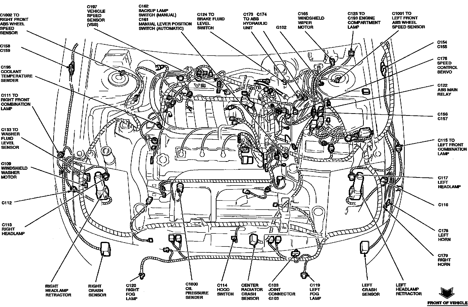

Part 3 of 3
Component Locations:
ABS HYDRAULIC UNIT
ABS MAIN RELAY
BACKUP LAMP SWITCH (MANUAL)
BRAKE FLUID LEVEL SWITCH
CENTER RADIATOR CRASH SENSOR
COOLANT TEMPERATURE SENDER
ENGINE COMPARTMENT LAMP
HOOD SWITCH
JOINT CONNECTOR
LEFT CRASH SENSOR
LEFT FOG LAMP
LEFT FRONT ABS WHEEL SPEED SENSOR
LEFT FRONT COMBINATION LAMP
LEFT HEADLAMP
LEFT HEADLAMP RETRACTOR
LEFT HORN
MANUAL LEVER POSITION SWITCH (AUTOMATIC)
OIL PRESSURE SENDER
RIGHT CRASH SENSOR
RIGHT FOG LAMP
RIGHT FRONT ABS WHEEL SPEED SENSOR
RIGHT FRONT COMBINATION LAMP
RIGHT HEADLAMP
RIGHT HEADLAMP RETRACTOR
RIGHT HORN
SPEED CONTROL SERVO
VEHICLE SPEED SENSOR (VSS)
WASHER FLUID LEVEL SENSOR
WINDSHIELD WASHER MOTOR
WINDSHIELD WIPER MOTOR
