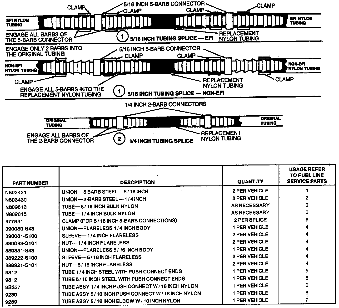

8. Complete the splice of the replacement nylon to the original nylon tubing at both ends. Refer to the illustration.
9. Tighten the clamps in the locations shown in the illustration.
