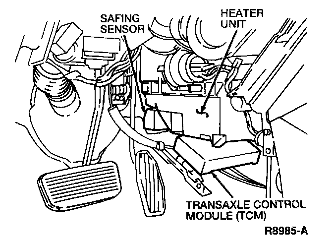

RemovalWARNING: THE BACKUP POWER SUPPLY ENERGY MUST BE DEPLETED BEFORE ANY AIR BAG COMPONENT SERVICE IS PERFORMED. TO DEPLETE THE BACKUP POWER SUPPLY ENERGY, DISCONNECT THE NEGATIVE BATTERY CABLE AND WAIT ONE MINUTE.
NOTE: The safing sensor is mounted on the bulkhead behind the floor console.
1. Disconnect the negative battery cable.
2. Remove the LH and RH floor console side panels.
3. Disconnect the safing sensor electrical connectors.
4. Remove the two safing sensor bolts.
5. Remove the safing sensor.
