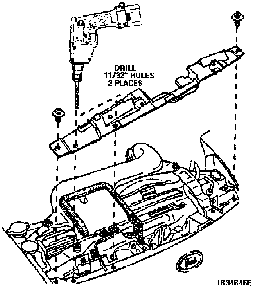

6. Reinstall the bumper set plate nut and bolt.
7. Temporarily install the new seal plate by using two clips saved in step 2. Drill two (2) 11/32" holes where indicated. Remove the new seal plate. Clean off metal shavings and apply Ford Super Seal Compound # F3AZ-19515-SA (or equivalent) to holes.
8. Fasten the new seal plate with the five (5) original clips, three (3) new washers and two (2) additional clips as shown. Make certain that you install three (3) washers in the proper position as indicated.
