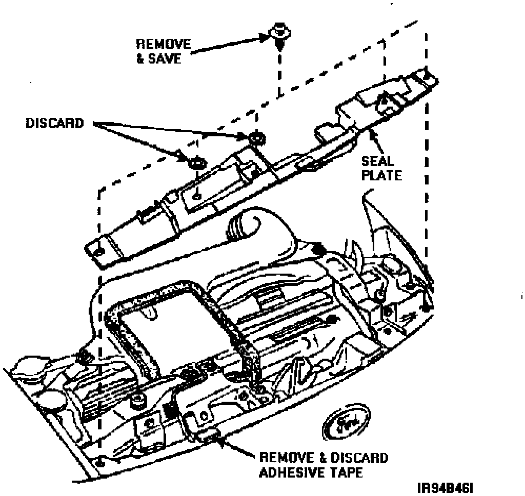

1. Open the hood.
2. Remove the seal plate from the vehicle and discard. Save the five (5) attaching clips. Discard two (2) washers
NOTE:
Vehicles produced during 9-1-93 thru 1-3-94 have adhesive tape between the seal plate and bumper. This adhesive tape should be removed.
NOTE:
Make certain that the following three (3) rubber seals are already installed on the vehicle:
^ 180 mm rubber seal located underneath bumper set plate.
^ 70 mm rubber seal in front of air duct.
^ 55 mm rubber seal next to the hood striker.
If either 180 mm or 70 mm rubber seal is not installed, install it by referring to Procedure A, Step 10.
If 55 mm rubber seal is not installed, install it by referring to Procedure A, Step 10.

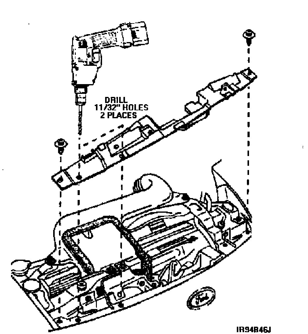

3. Temporarily place the new seal plate by using two (2) clips retained in step 2. Using the new seal plate as a pattern, drill two (2) 11/32" holes where indicated. Remove the new seal plate. Clean off metal shavings and apply Ford Super Seal Compound # F3AZ-1 951 5-SA (or equivalent) to holes.

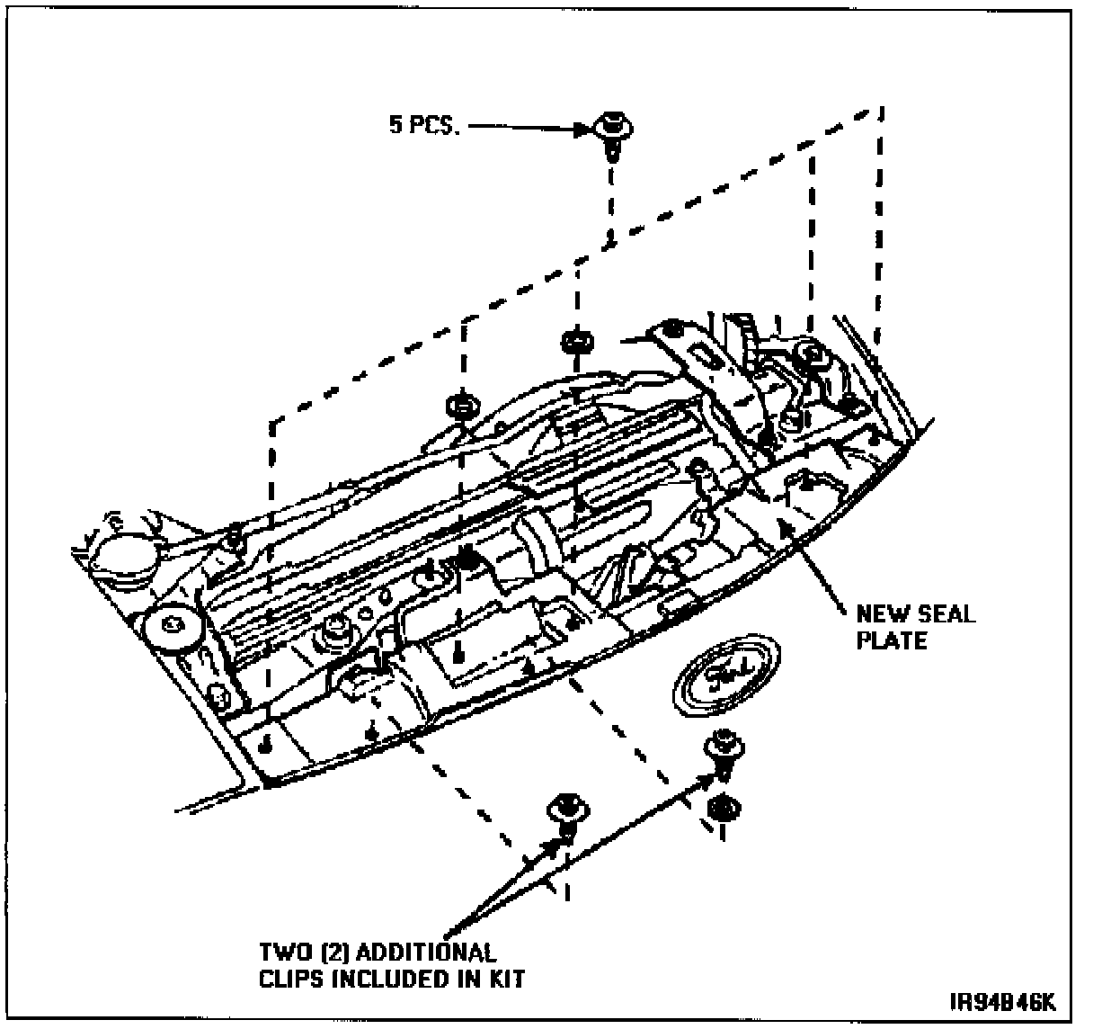

4. Fasten the new seal plate with the five (5) original clips, three (3) new washers and two (2) additional clips as shown. Make certain that you install three (3) washers in the proper position as indicated.
5. Discard three (3) rubber seals included in the kit, unless needed in Step 2.
