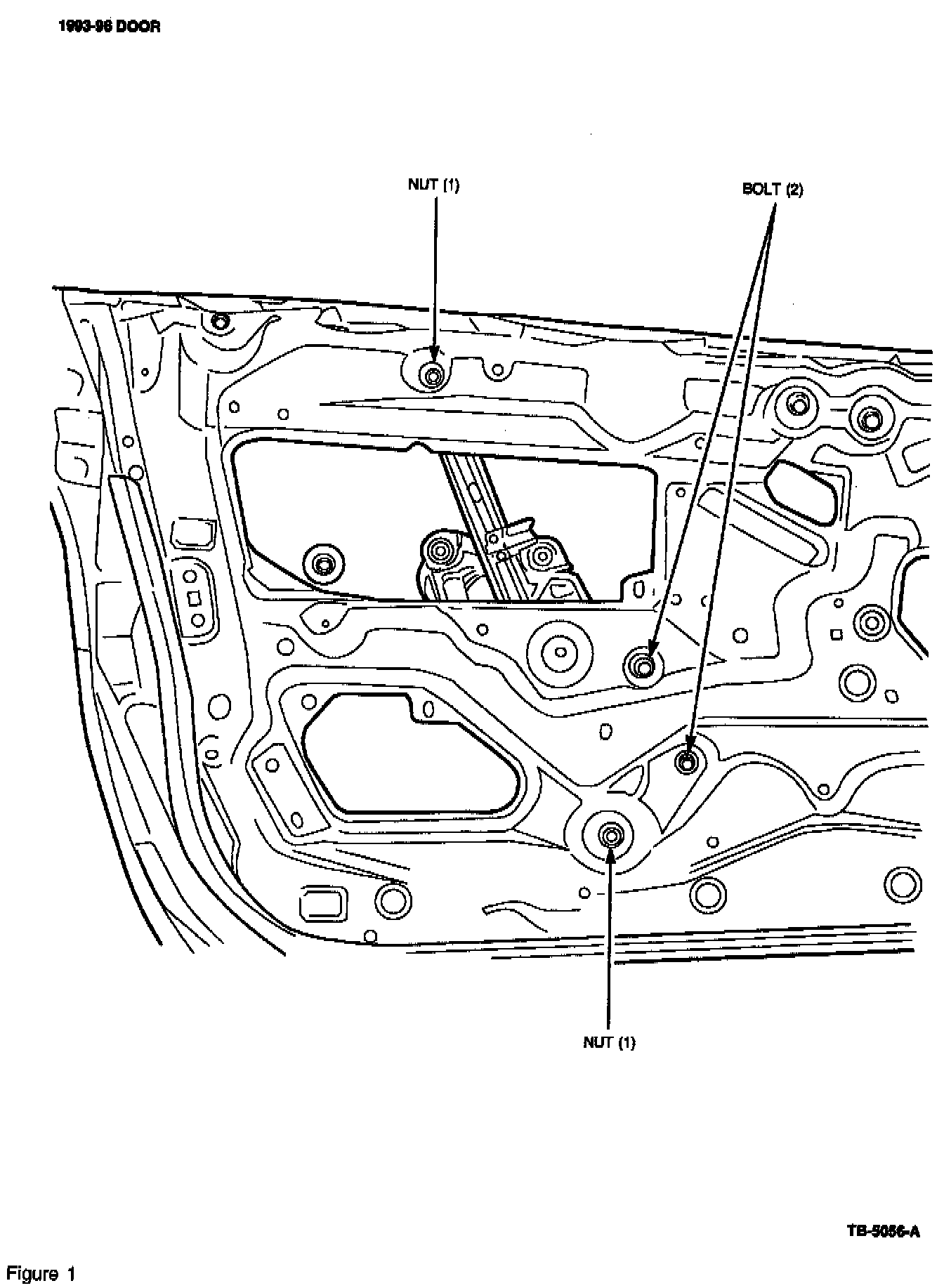

2. Remove the two (2) power window regulator bolts and two (2) power window regulator nuts (Figure 1).
3. Disconnect the power window regulator electrical connector and remove the regulator through the service hole.

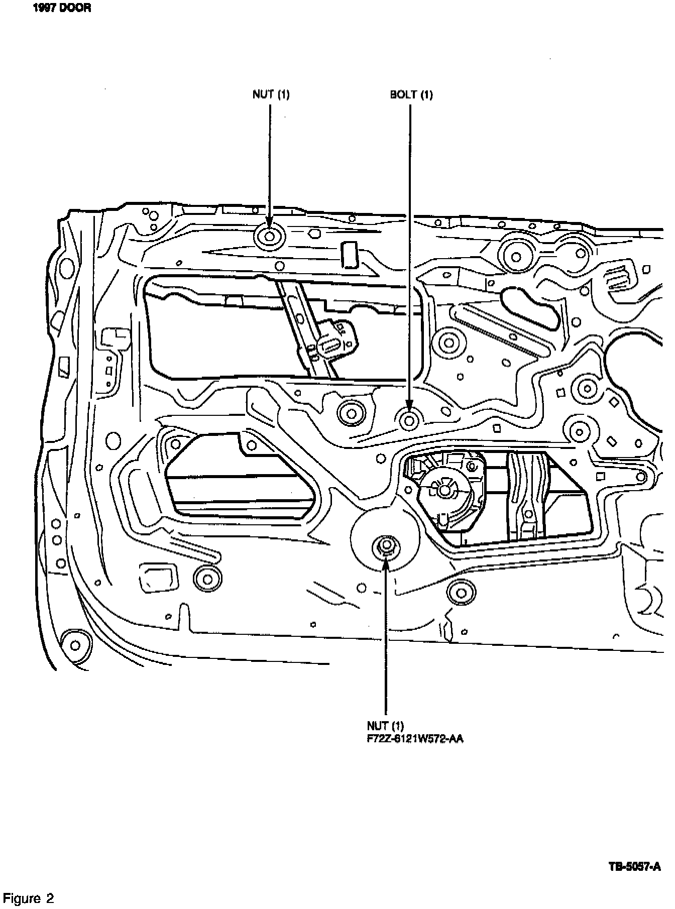

4. Install the power window regulator into the new 1997 level door through the service hole.
5. Mount the power window regulator to the door by installing the power window regulator upper nut (1) and power window regulator upper bolt (1) (Figure 2).
6. Tighten the power window regulator bolt (1) to 7-10 N-m (60-87 lb-in). Tighten the power window regulator nut to 22-24 N.m (16-18 lb-ft).
7. Discard the remaining nut (1) and bolt (1).
8. Install the new Nut/Washer (F72Z-6121W572-AA) to the lower attachment (Figure 2).
9. Tighten the new nut/washer to 22-24 N-m (16-18 lb-ft).
