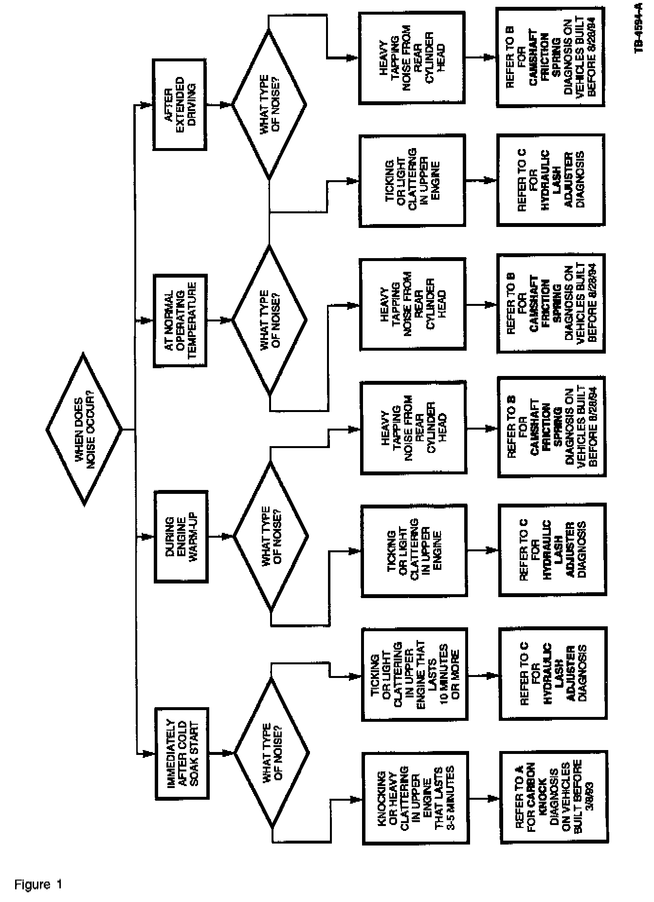

2.5L V6 ENGINE NOISE DESCRIPTION
Refer to Engine Noise Flowchart (Figure 1) for the following noise descriptions.

A. Carbon Knock - If a top of engine knock noise is heard when starting a cold engine and decreases after the engine warms up, carbon may have accumulated in the combustion chamber and on the piston tops. Carbon accumulation reduces the clearance between the piston and cylinder head, causing contact and noise during combustion (Figure 3). This noise can be mistaken as HLA noise. Carbon knock can be distinguished from HLA noise by increasing the engine speed. Carbon knock noise will lessen or disappear as engine speed reaches approximately 2500 rpm. If carbon is suspected, perform the following Carbon Cleaning Procedure.

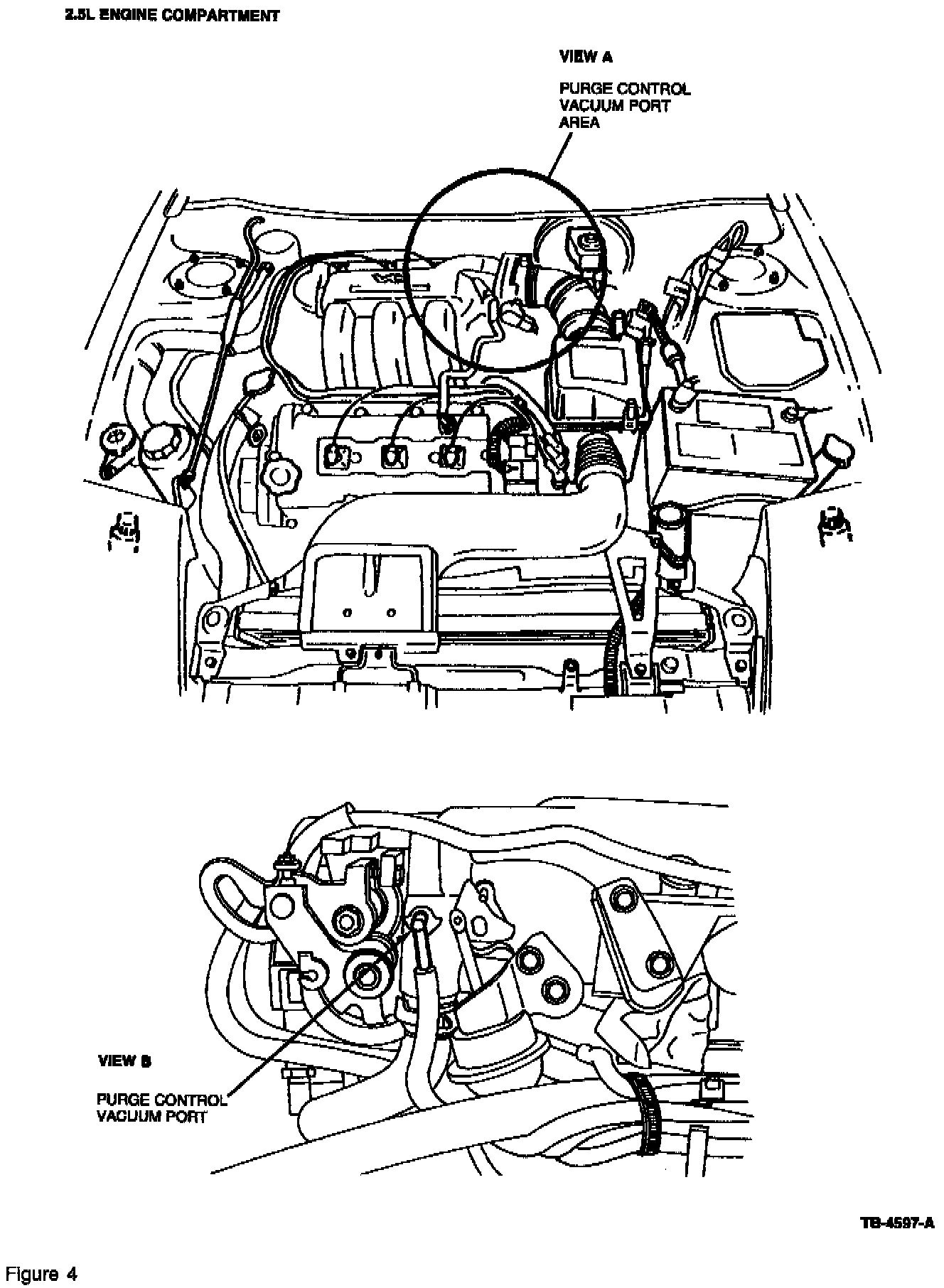

2. Obtain a 610 mm (2') length of 1/8" I.D. vacuum hose for use as a feed tube for the carbon cleaner.
3. Connect one end of the feed tube to the purge control vacuum port on the upper intake manifold (Figure 4) and place the other end of the feed tube in the can of Carburetor Tune-up Cleaner (D9AZ-19579-BA).

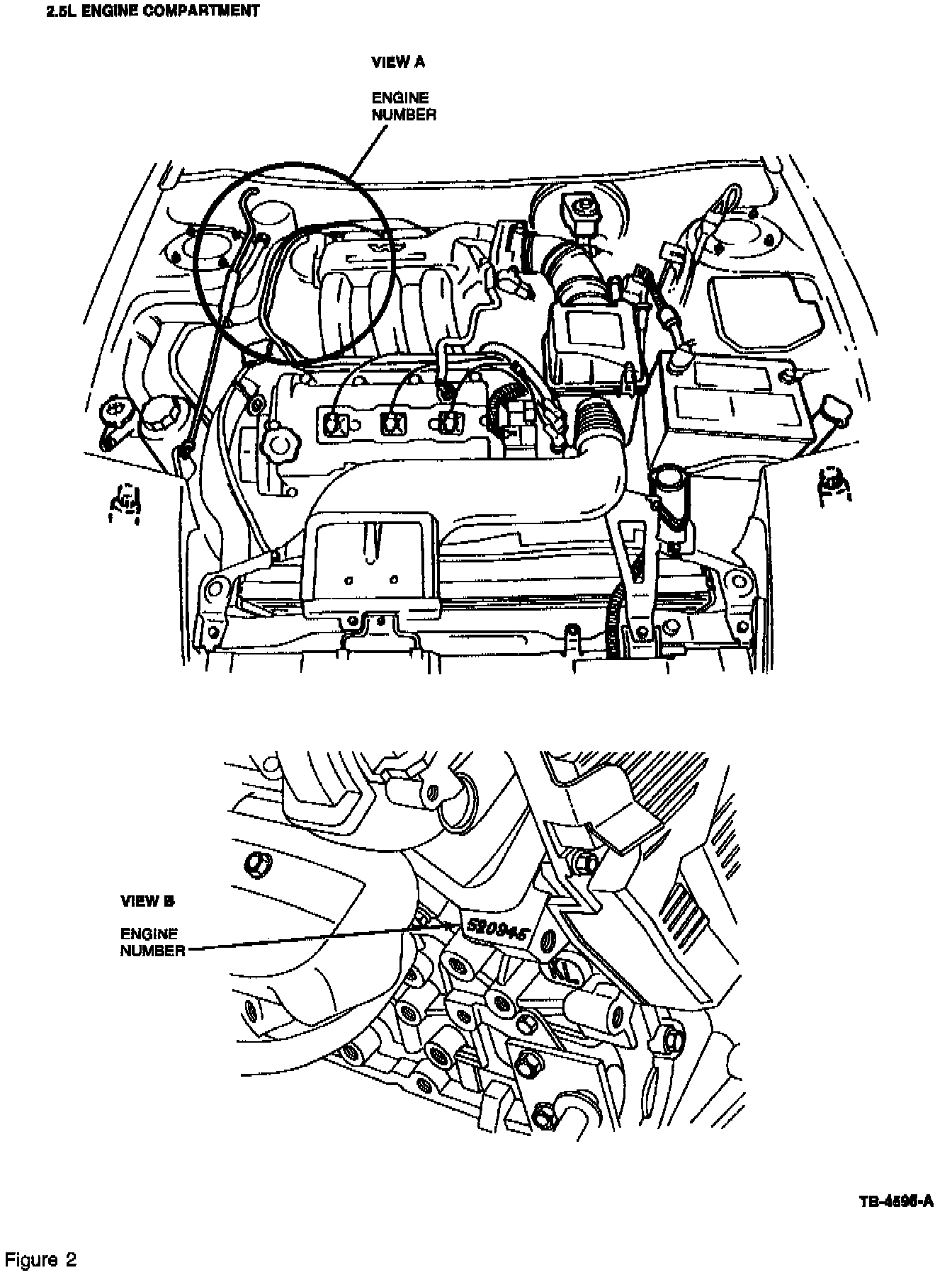

B. Camshaft Friction Gear Noise - A heavy tapping noise may be heard from the right rear cylinder head exhaust camshaft area directly behind the timing cover (Figure 5). The tapping starts during engine warm-up and the noise level can increase as the engine reaches normal operating temperatures. In some cases, the noise may begin to oscillate in 3-5 second intervals.
Using a stethoscope, or equivalent, listen to the engine just behind the timing belt area on the valve covers (Figure 5).
If a "tapping" or "clacking" type noise is heard, refer to TSB Article 96-6-4 for the proper repair procedure.

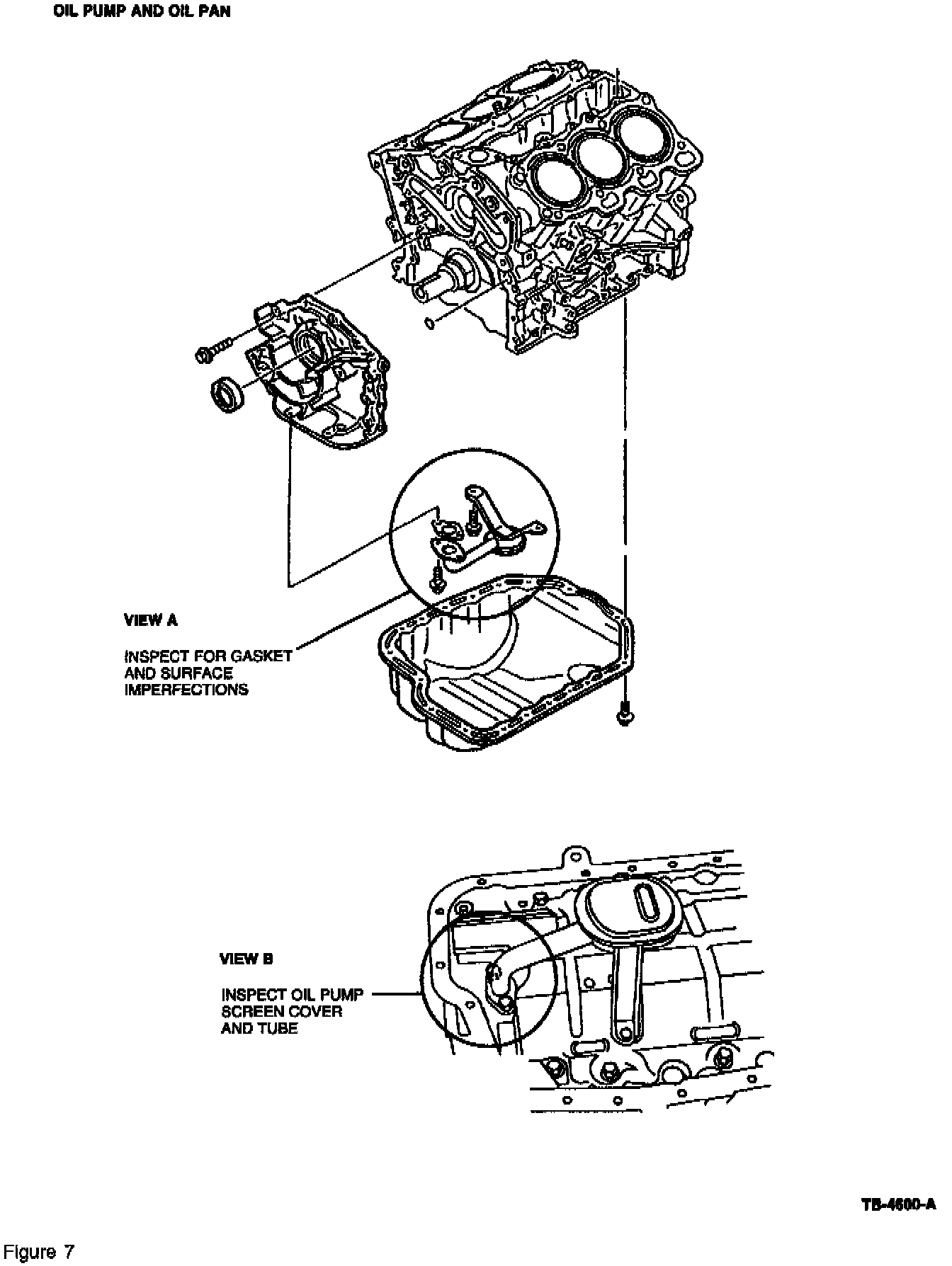

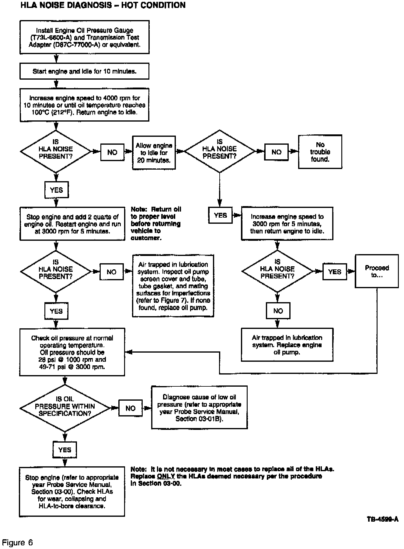

C. Hydraulic Lash Adjuster (HLA) Noise - A noise heard from the top of the engine area which can be described as a "ticking" or "clattering" type noise at various engine temperatures. The noise level varies depending on the number of HLA's that are making the noise. HLA noise can occur due to internal failure of the HLA, air trapped in the lubrication system, or low oil pressure. Verify the concern by:
1. Check oil and filter condition. Check for proper engine oil level. In many cases a simple oil (Motorcraft 5W30) and filter (Motorcraft FL-822) change may eliminate the noise concern. If after changing the oil and filter, the noise is still present, go to Step 2.
NOTE:
SOME HLA NOISE WHEN THE ENGINE IS COLD AND FIRST STARTED IS NORMAL. THE LENGTH OF TIME THE HLA NOISE LASTS WILL VARY DEPENDING ON AMOUNT OF TIME THE VEHICLE HAS BEEN SITTING OR IN STORAGE.
2. Refer to HLA Noise Diagnostic Flowchart (Figure 6, which includes a reference to Figure 7) for repair recommendations.
