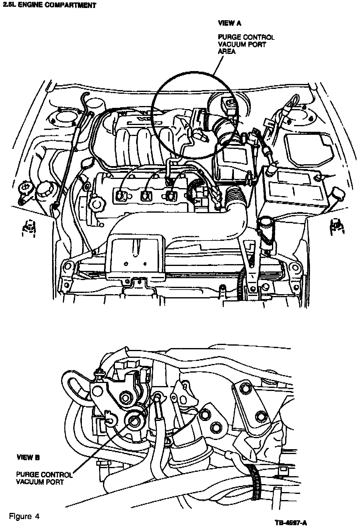

2. Obtain a 610 mm (2') length of 1/8" I.D. vacuum hose for use as a feed tube for the carbon cleaner.
3. Connect one end of the feed tube to the purge control vacuum port on the upper intake manifold (Figure 4) and place the other end of the feed tube in the can of Carburetor Tune-up Cleaner (D9AZ-19579-BA).
