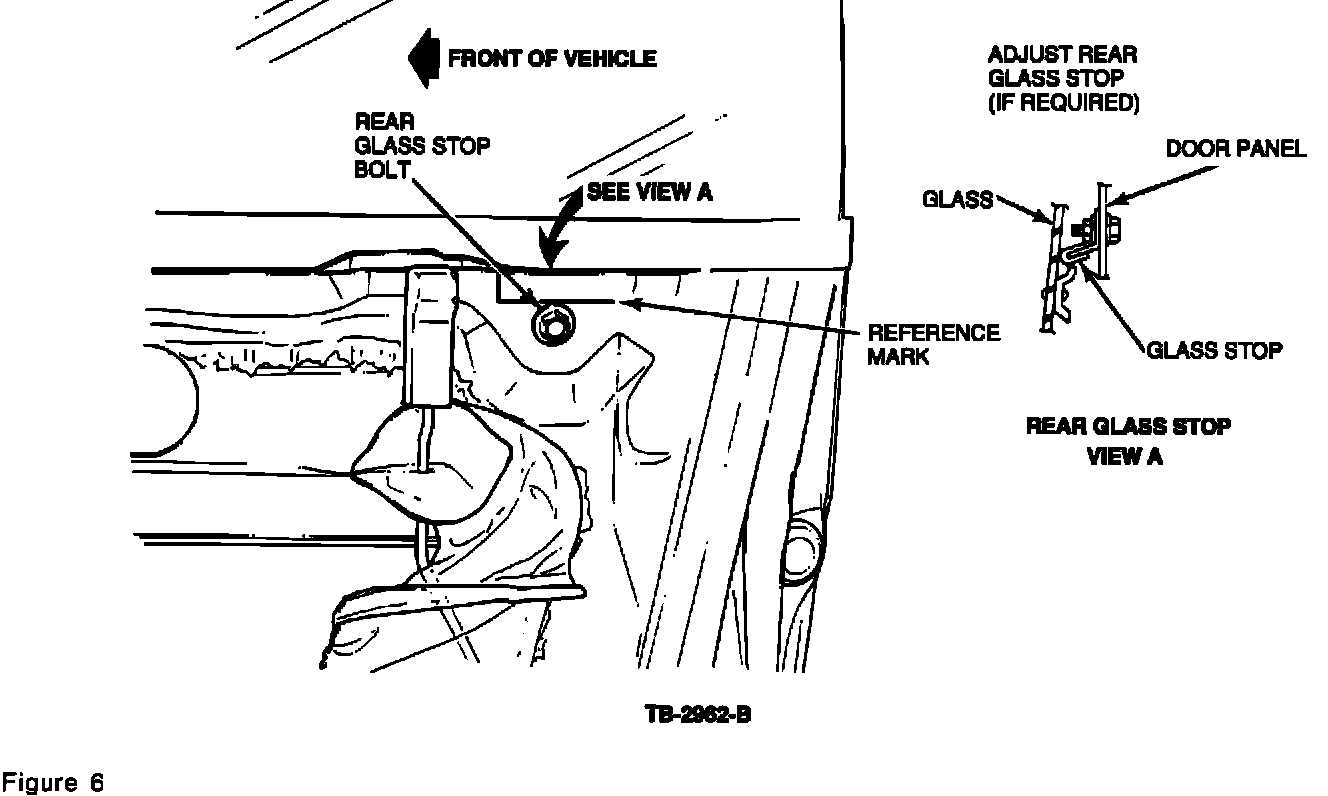

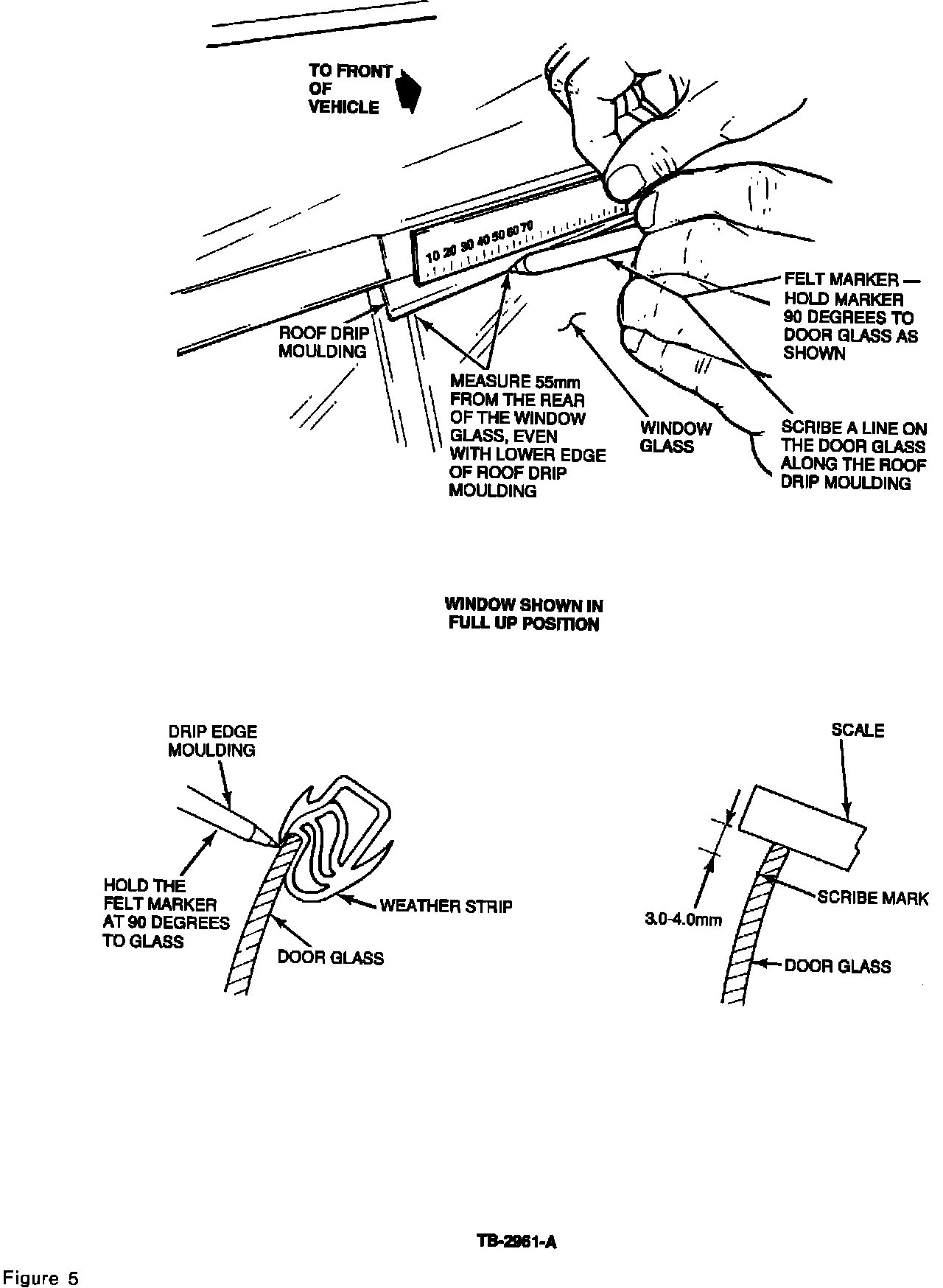

5. Check the door glass rear height adjustment. Adjust if necessary.
a. With the window in the full up position and the door closed, draw a line along the top of the glass with a felt marker. Locate the line 55 mm from the rear of the glass even with the lower edge of the roof drip moulding, Figure 5. The mark must be 3-4 mm from the top edge of the glass.
b. If adjustment is required, lower the window 1" (25.4 mm) and make a reference mark on the door. See Figure 6.
c. Loosen the glass stop bolt just enough to be able to slide the stop and move the stop the same distance the mark is out of specification. Example: If the glass is 1.0 mm too high, lower the stop 1.0 mm.
d. Tighten the glass stop bolt.
e. Raise the window and recheck.

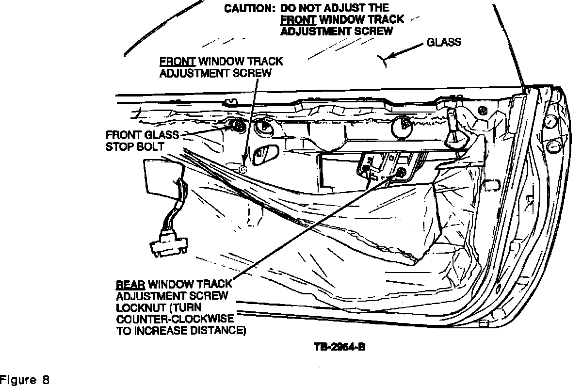

6. Check the door glass rear inboard and outboard adjustment. Adjust if necessary.
NOTE:
DO NOT ADJUST THE FRONT WINDOW TRACK INBOARD AND OUTBOARD ADJUSTMENT SCREW.
a. With the glass in the full up position, close the door until the top rear corner of the glass lightly touches the weatherstrip. See Figure 6.
b. Measure the distance between the "B" pillar weatherstrip surface and the outside of the glass. See Figure 7. This distance must be between 14-19 mm.
c. To adjust, loosen the adjustment screw locknut, Figure 8, and turn the adjustment screw counter-clockwise to increase the distance.
d. Tighten the adjustment screw locknut.
e. Recheck the distance between the "B" pillar weatherstrip surface and the outside of the glass.

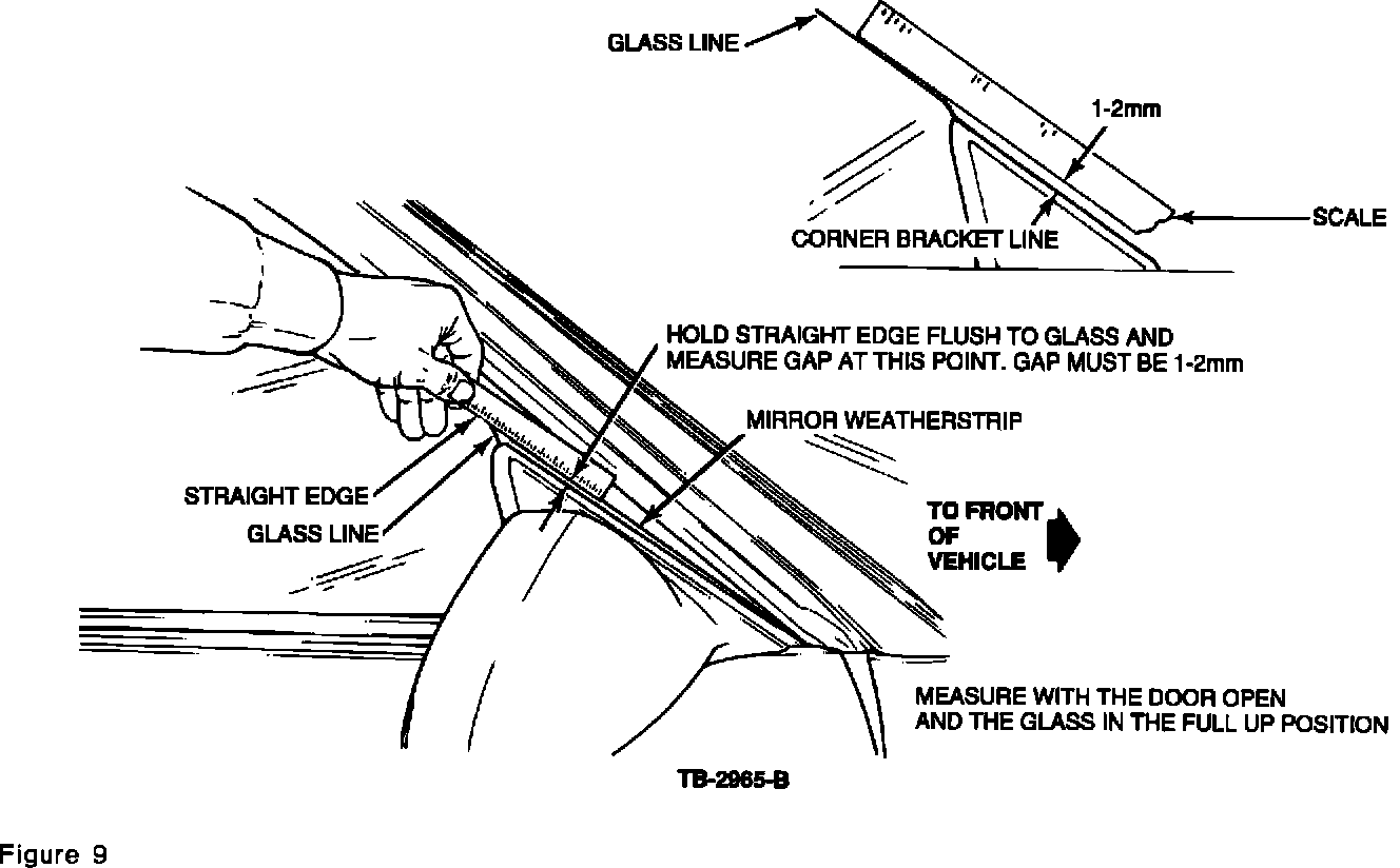

7. Check the door glass front height adjustment. Adjust if necessary.
a. With the glass in the full up position, place a straight edge on the glass. See Figure 9.
b. Measure the gap between the straight edge and the top of the mirror weatherstrip. The gap must be 1-2 mm.
c. If adjustment is required, lower the window 1" (25.4 mm). Loosen the front glass stop bolt, Figure 8, and move the stop the distance required to obtain the 1-2 mm gap as shown in Figure 9.

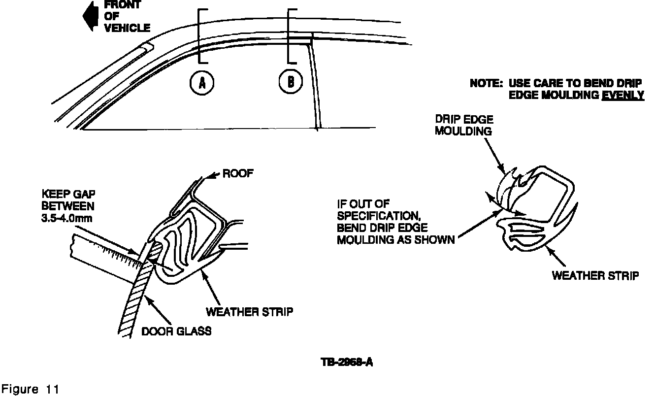

8. Check the drip edge moulding to door glass gap. Adjust if necessary.
a. Measure the gap between the door drip edge moulding and the outside glass surface along the horizontal area of the top of the glass. See Figures 10 and 11 - points A through B. The correct gap is 3.5-4.0 mm.
b. Use your hands to adjust the drip edge moulding by applying pressure to bend the moulding to provide the required gap. Use caution to bend the drip edge moulding evenly to avoid a wavy appearance.
