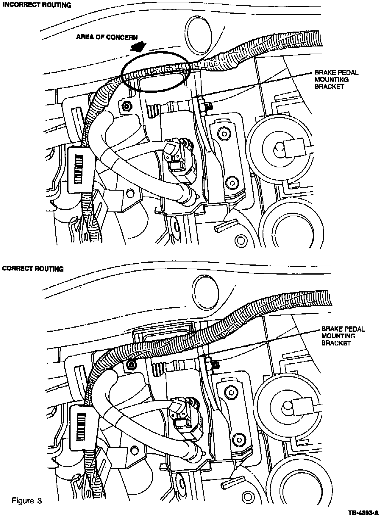

^ Wires may be pinched/cut between brake pedal mounting bracket and body.
^ Using a flashlight, inspect air bag wire harness routing along brake pedal mounting bracket (Figure 3).

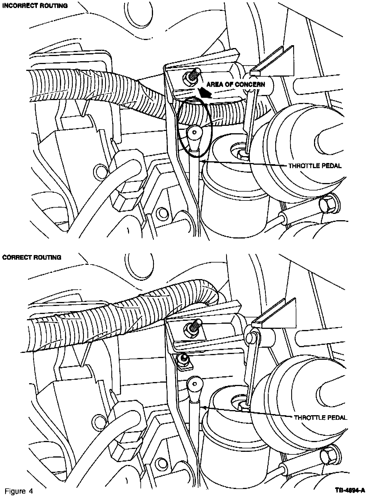

^ Wires may be chafed or cut above the throttle pedal (Figure 4).
^ Using a flashlight, inspect air bag wire harness routing in area above throttle pedal (Figure 4).

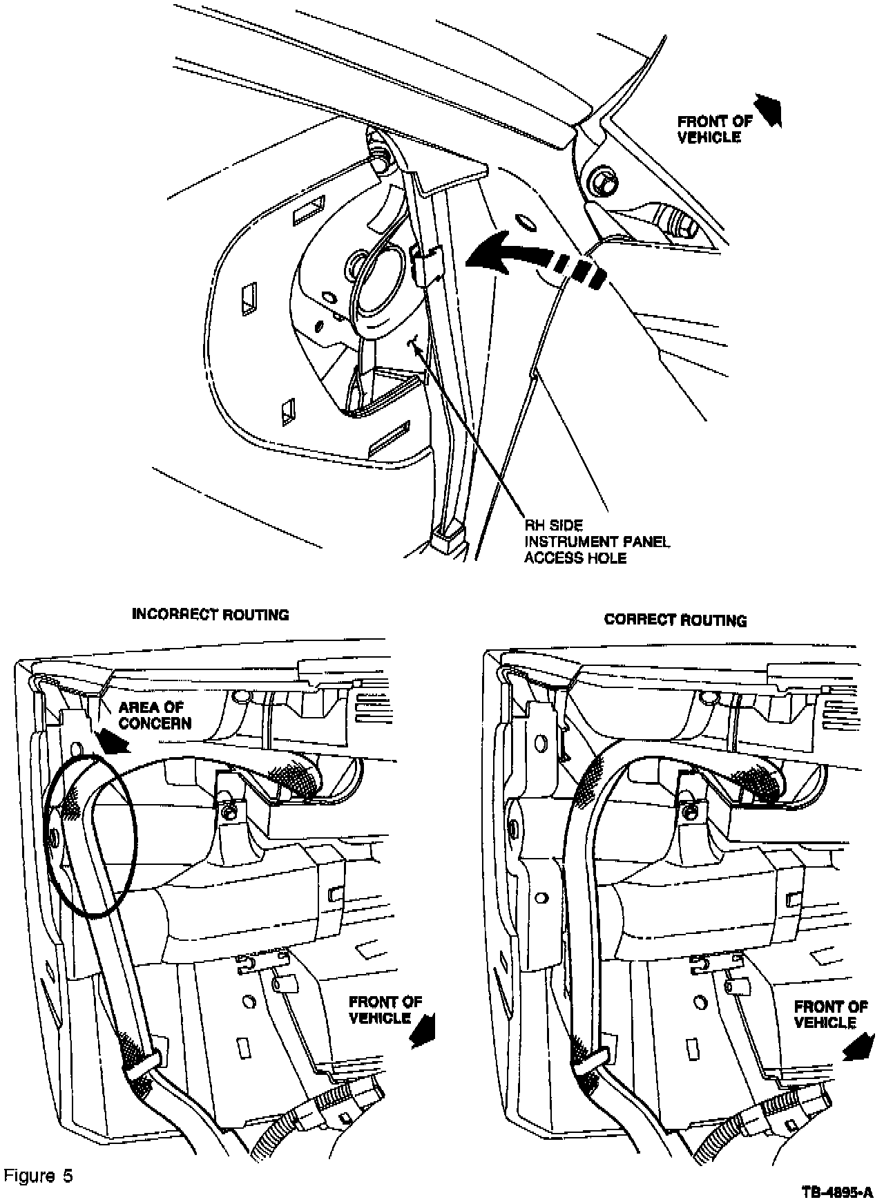

^ Wires may be pinched/cut between instrument panel and body on RH side behind glove compartment.
^ Lower glove compartment door and RH instrument panel access cover. Using a flashlight, inspect air bag wire harness routing for pinch points and/or cuts (Figure 5).
