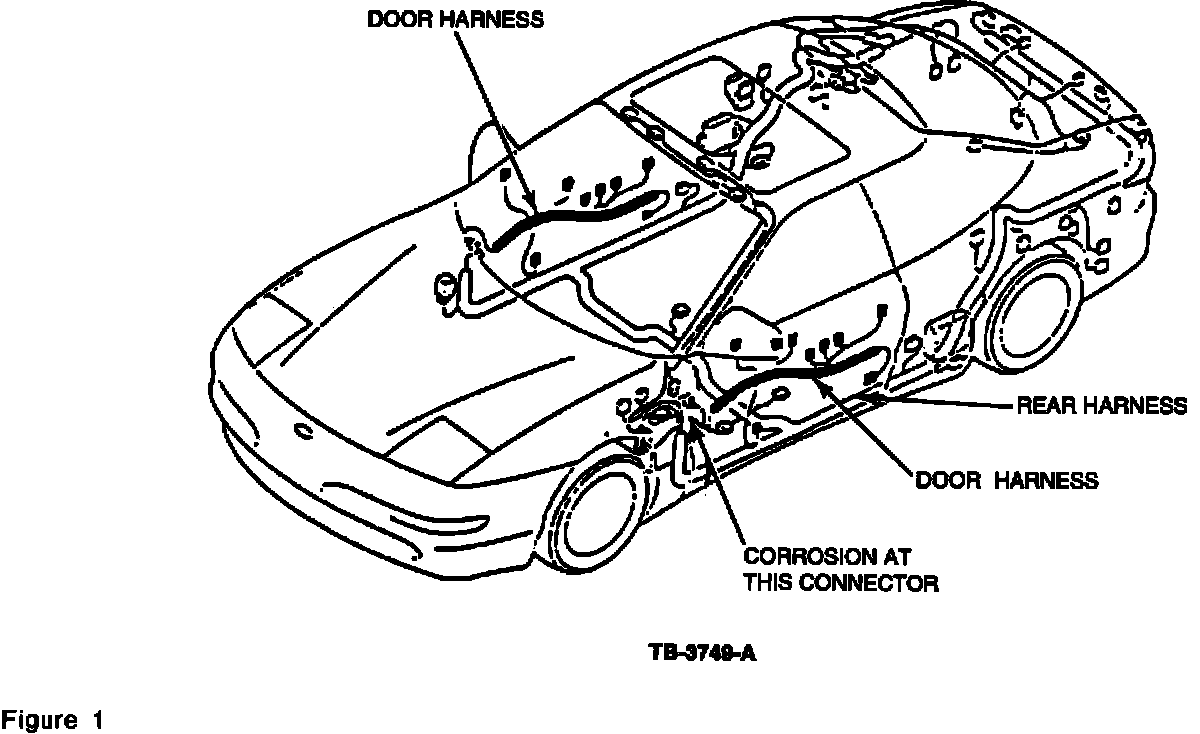

Some vehicles may exhibit a loss of some or all power accessories to either front door. This can occur on some vehicles if the door electrical wiring harnesses are corroded at the connector located in the "A" pillar after extensive accumulation of mileage. Electrical systems such as power windows, power door locks and power mirrors may malfunction. This occurs because water enters the connector.

3. Inspect the condition of the "A" pillar electrical connector. Refer to Figure 1.

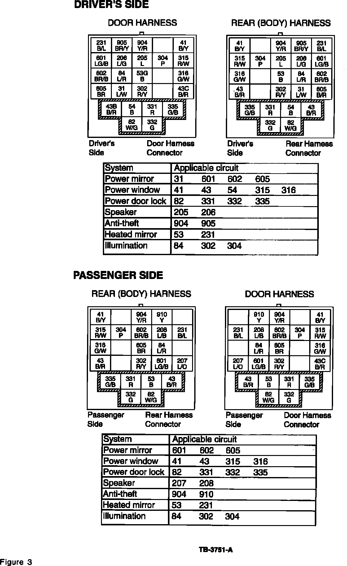

3. Repair the harness by using the appropriate pigtail from the Repair Kit Application Chart. If only one or two wire terminals are corroded and the connector shell does not have any damage, pull out the damaged wire terminals from the pigtail and replace the defective wires with new ones.
4. Refer to Figure 3 for proper wire arrangement.
