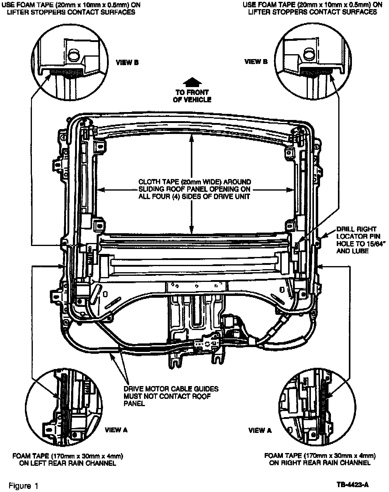

7. Refer to Figure 1 for Steps 7a through 7d.
a. Apply foam tape (approximately 170 mm long x 30 mm wide x 4 mm thick) to both outer edges of rain channel (Figure 1, View A).
b. Apply felt tape (approximately 20 mm long x 10 mm wide x 0.5 mm thick) to both lifter stoppers contact surfaces (Figure 1, View B).
c. Apply cloth tape (approximately 20 mm wide) to sliding roof panel opening on all four (4) sides of drive unit.
d. Using a 15/64" drill bit, enlarge the RH sliding roof panel drive locator hole and lubricate locator hole with teflon grease or equivalent.

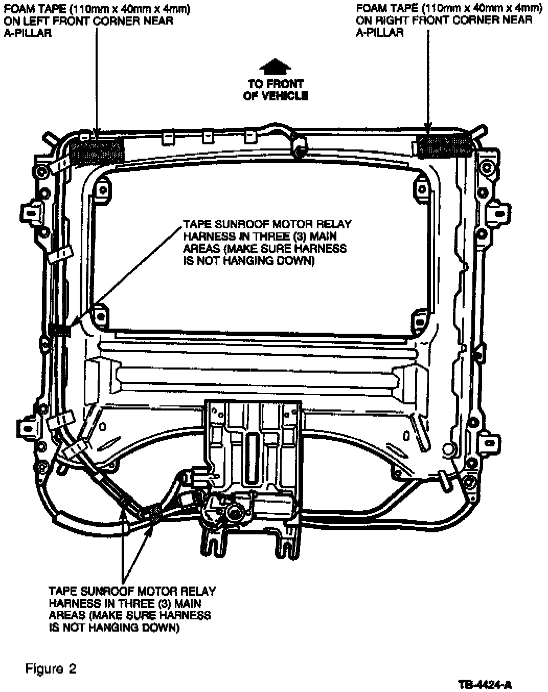

9. Refer to Figure 2 for Steps 9a and 9b.
a. Apply foam tape (approximately 110 mm long x 40 mm wide x 4 mm thick) to both front corners of sliding roof panel drive.
b. Secure sliding roof panel drive wire harness to sliding roof panel drive at areas indicated in Figure 2.
NOTE:
HARNESS SHOULD NOT HANG DOWN WHERE IT COULD CONTACT THE HEADLINER.

NOTE:
MAKE SURE THAT THE DRIVE MOTOR CABLE GUIDES DO NOT CONTACT THE ROOF PANEL WHEN INSTALLED (FIGURE 1).
