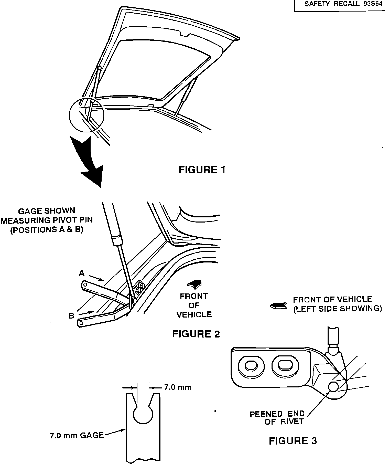

1. Open the liftgate. Figure 1.
2. Measure the diameter of the peened end (bracket side) of the rivet (see Figure 3) that attaches the liftgate strut, using the 7.0 mm gauge provided. It should be measured in at least two different places. See A & B, Figure 2.
(NOTE:
This Is done by placing the open end of the gauge flat against the bracket and sliding it toward the peened end of the rivet).
3. If either measurement result is:
a. OVER 7.0 mm Gauge won't slide by peened end. This liftgate strut is O.K., repeat step two for the other side.
b. UNDER 7.0 mm Gauge will slide by peened end. This lift gate strut MUST be replaced. Proceed to the replacement procedure.

1. Open the liftgate, have an assistant hold the liftgate.
2. Remove the strut from the ball stud, remove and discard the ball stud.
3. Remove the two lower bolts (12 mm.) from the bottom strut bracket and remove strut.
