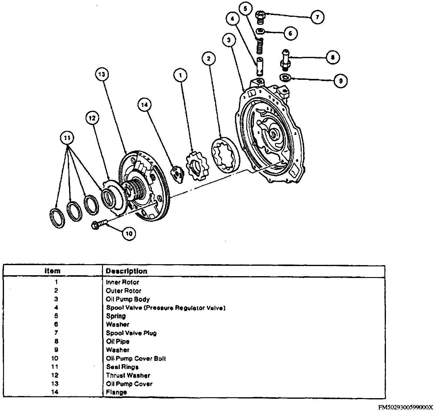

DISASSEMBLEExploded View Of Oil Pump:
NOTE: Refer to the Exploded View Of Oil Pump image when disassembling the oil pump.

ASSEMBLE
1. Install spool valve and spring, then new washer and spool valve plug. Torque plug to 24-34 ft lbs.
2. Install outer rotor, then the inner rotor. Line up alignment mark between inner and outer rotor.
Oil Cover Bolt Tightening Sequence:
3. Install flange, then oil pump cover. Torque cover bolts to 71-88 in lbs in sequence shown in the Oil Cover Bolt Tightening Sequence image.
4. Use oil pump shaft to check for smooth pump operation, then install new seal rings.
5. Apply petroleum jelly to thrust washer and install washer on pump cover. Outer diameter of thrust washer should be 3.46 inches.
